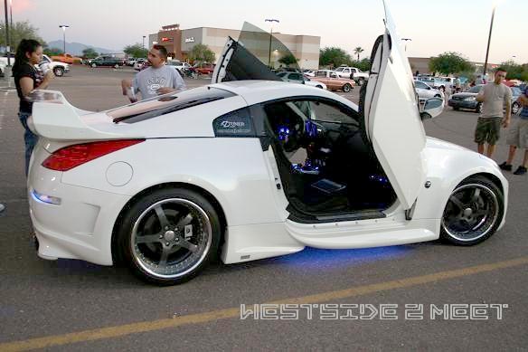

Originally Posted by L33TZOR
Well, I always suggest more tire is better than more rim. I don't get the whole stretched out tire fad thing with hella negative camber on a performance car it just doesn't add up.
IMHO, anyone could save a ton of issues getting the right fitment tire and wheel in the first place and this post would seize to exist homie.
Another good tip for the OP would be don't do this to your car

Calin... where did you find that pic of my car?! hahahaha
