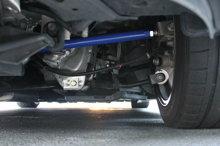

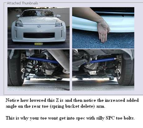

Brazen,
These pictures may help you visualize what sikky is saying about the rear arms angling upwards when lowered!
This guy has lowered his car and you can see his crappy circuit sport toe arms pointing up big time:
The comments on the pictures are because i plan on adding them to my suspension 101 thread, but just haven't yet...
So, to recap, raising the subframe with reduced height bushings, then raises the mounting point of the arms on the car side, versus the wheel side and thus gets your suspension geometry back where you want it...
