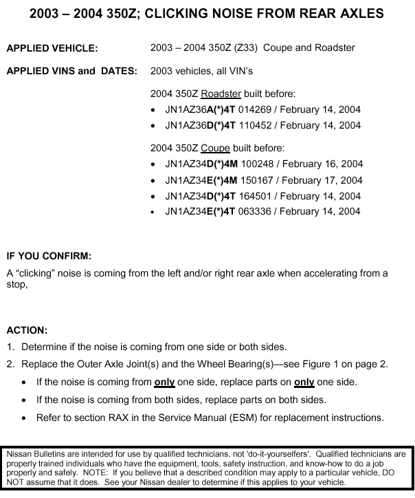

Here you go bud, just print this out and show it to them. I went to Tustin NISSAN and showed him this TSB and they fixed it within a day (although i made an appointment). They should not have a problem once you show them this:
The funny thing is that I showed them thaat.
they should fix this without a problem. even if the car was a 2nd hand car, they have to honor the 36,000 mile bumper to bumper....just go to another dealer if you can. the stealership should do the work without any hassle.
