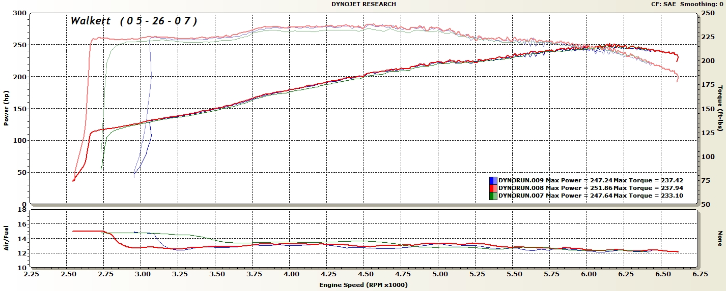

Mine = aem intake-5/16-portpolish-strupH-nismoEX- 251rwhp-238rwtq my a/f is right at 13.4
Before the headers mine only had 225rwtq same peak HP but gained 10hp at 3400 rpm- 5100rpm from the headers. One of my dyno sheets is here
