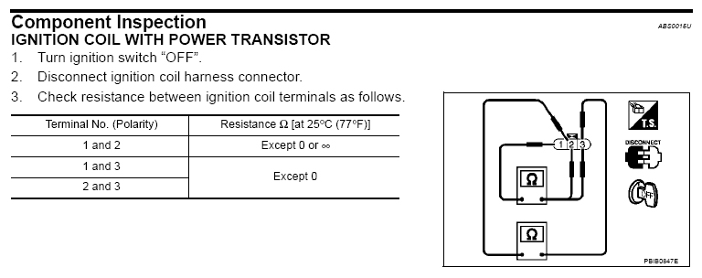

Ok, so I believe that my e-manage fried out one or two of my coil packs, my check engine code is flashing car is running goofy like hesitant, I had just been driving and it was running perfectly and I parked it at the mall and left the key in the ignition for a few min which i normally dont do but I had gotten a phone call and after that the car was running all f'ed up. How do i test my coil packs, I already took each of them off and look at them and they all appeared fine, is there something i can hook up to them to check them or is there something in particular i should be looking for?

you can swap the coil packs and see if the misfire follows. What a PIA though, that sucks. Everyone tells me the issue with the EU isn't a big deal but I certainly do not want to deal with that kind of crapola. Sorry for you man.

Here is a start
