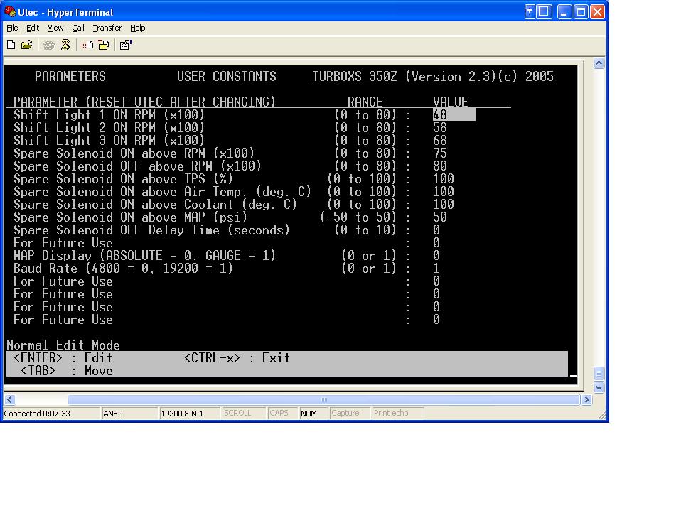

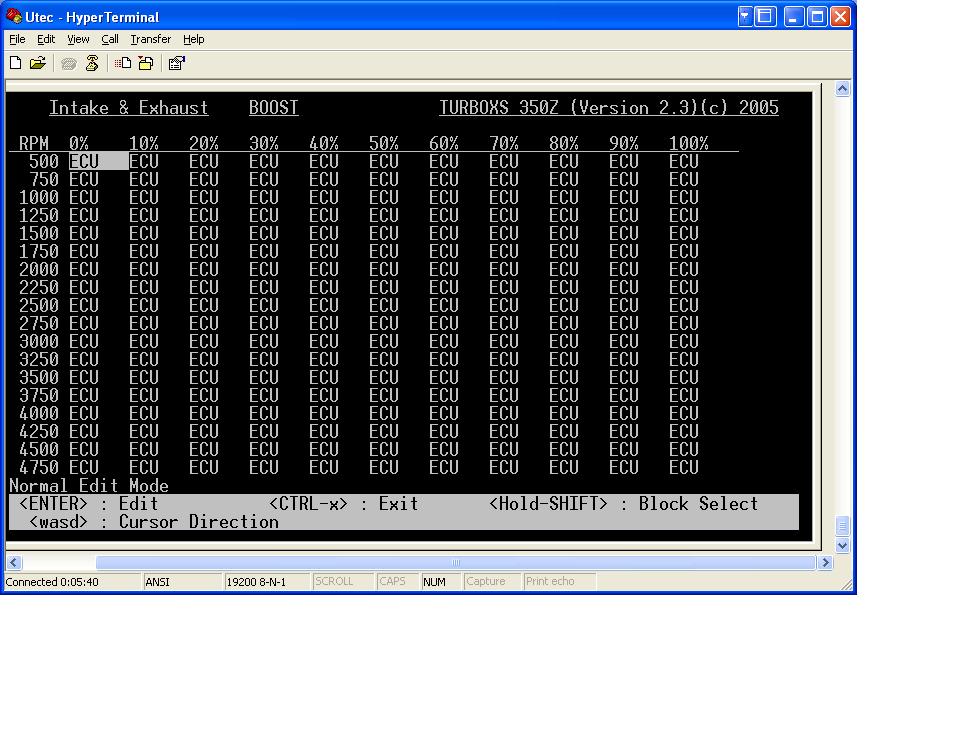

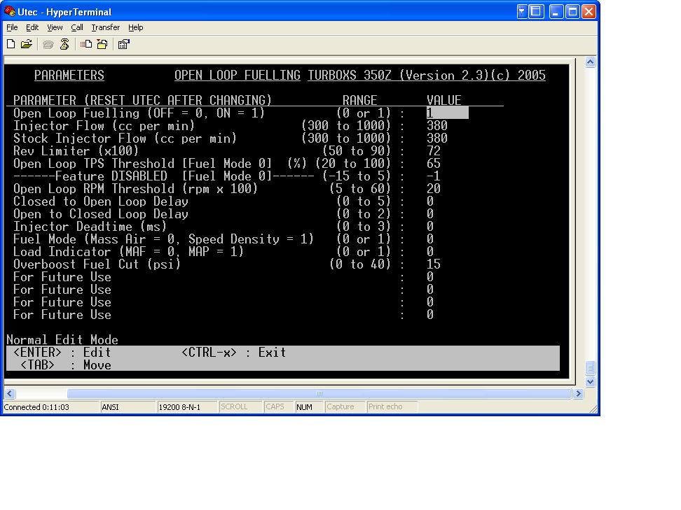

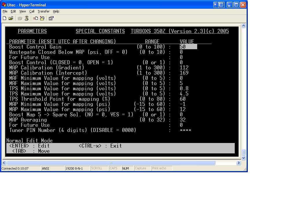

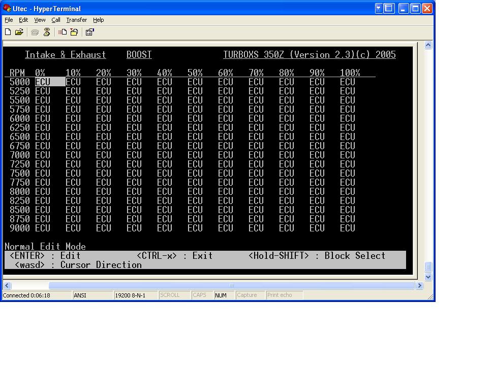

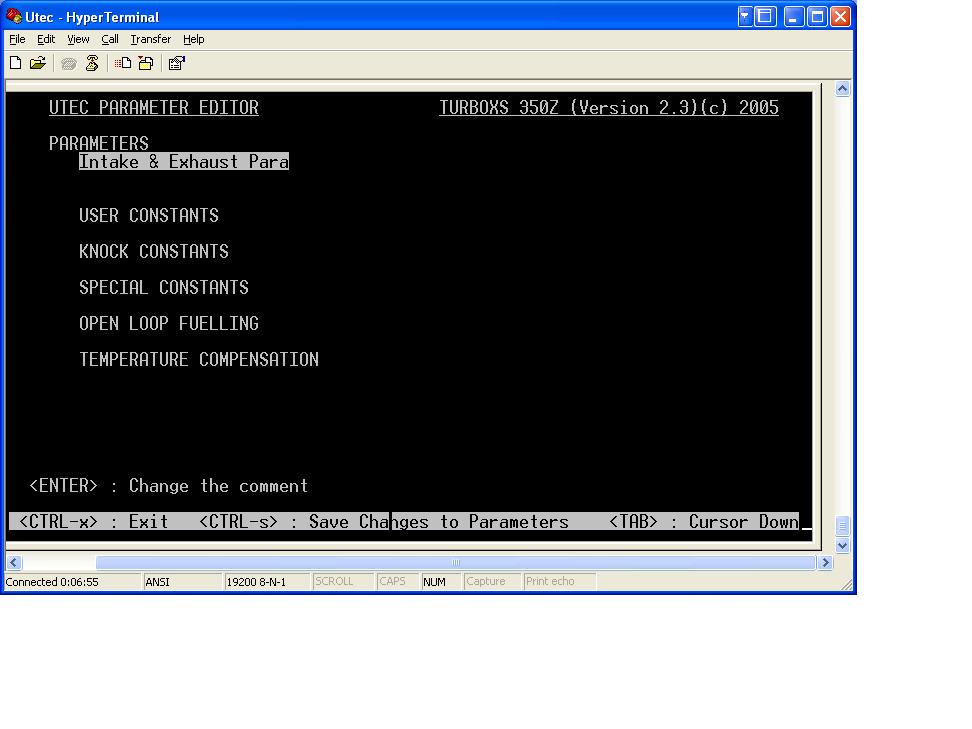

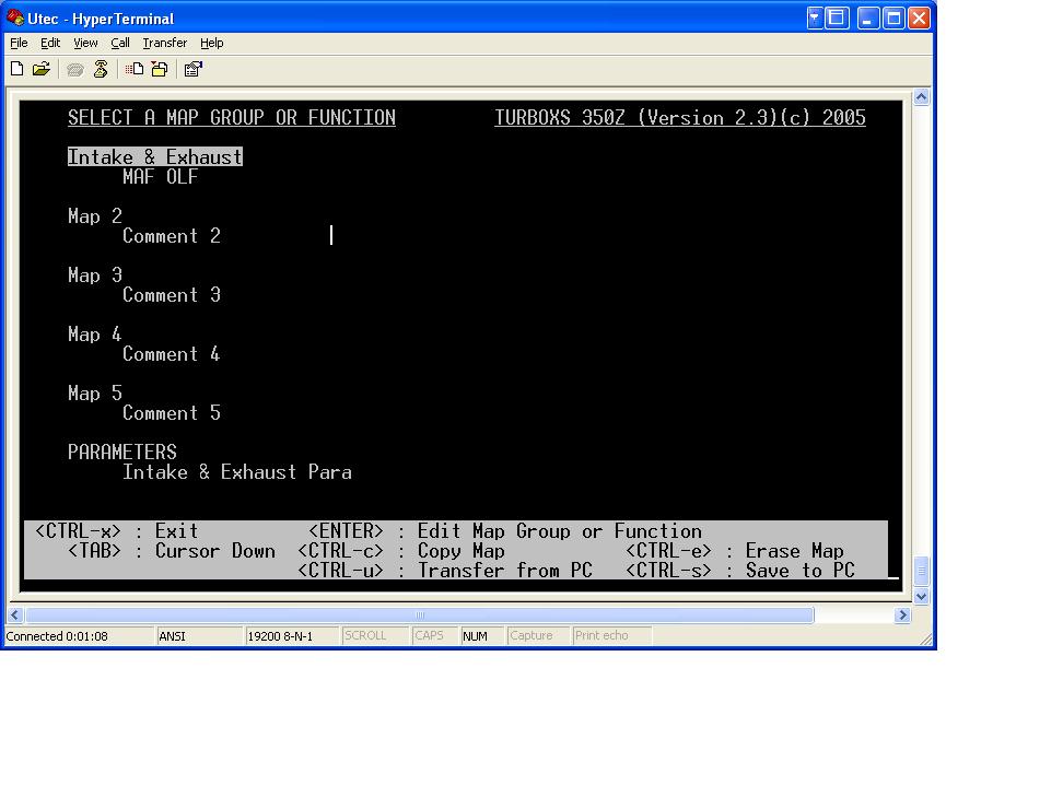

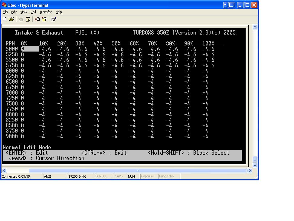

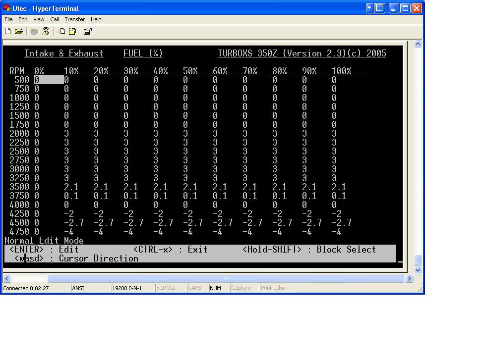

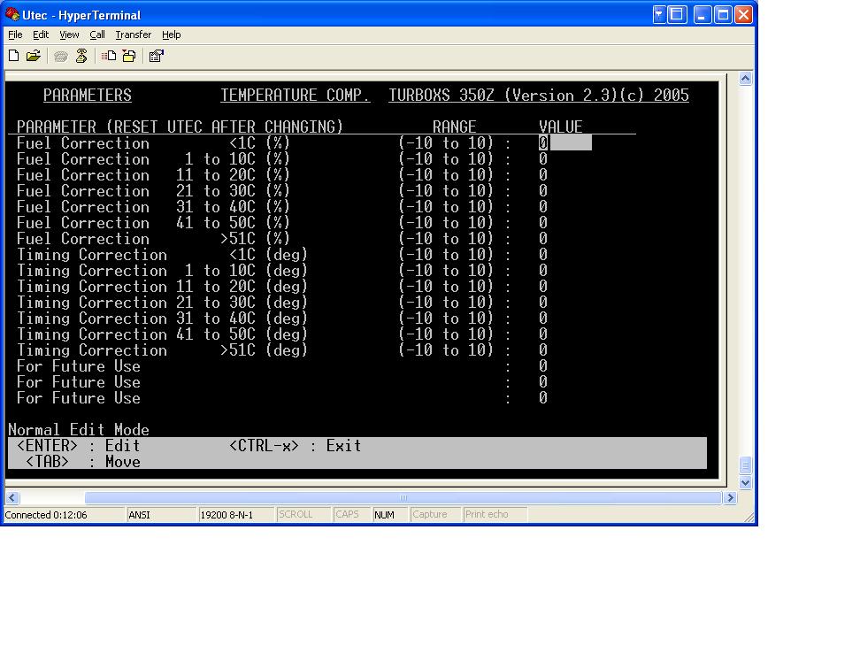

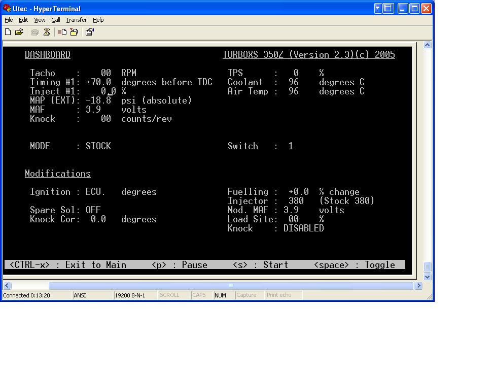

I have tried just about everything possible. I am posting some screen shot of the UTEC settings so that all the experts can check it out.
As it stands right now, the UTEC is loaded with the Base NA Map from TurboXS on Map1. The NA Parameters from TurboXS are loaded as well.
The Map selector on the UTEC is set to Map1 as I do not have a Map Selector Switch.
I pulled the codes being thrown whenever the UTEC is hooked up. This a copy from the Cipher itself.
5/21/06
-------- ECU --------
Found: 3 codes!
P1122,Electronic Throttle Control Actuator
P0102,MAF Sensor
P1126,Throttle Control Motor Relay
5/21/06
Found: 2 codes!
I have reflashed the UTEC using the default settings from the flash and it's the same thing. I have also tried all default settings on all Maps which should do nothing different.
Regardless of what I adjust, the UTEC continues to do the exact same thing. As soon as you disconnect it and run the OEM ECU alone the car runs perfect with no codes.
The following are all the screen shots I thought might be useful to anyone who is familiar with the UTEC.

Have you tried running it with the map selector switched to 0?
Are both the little switches inside the UTEC just below the TurboXS logo switched down towards the connectors?
The map you have loaded looks fine to me, identical to my map #1. If you can get a screenshot of the dashboard while connected to the ECU while the Z is running it *might help...
