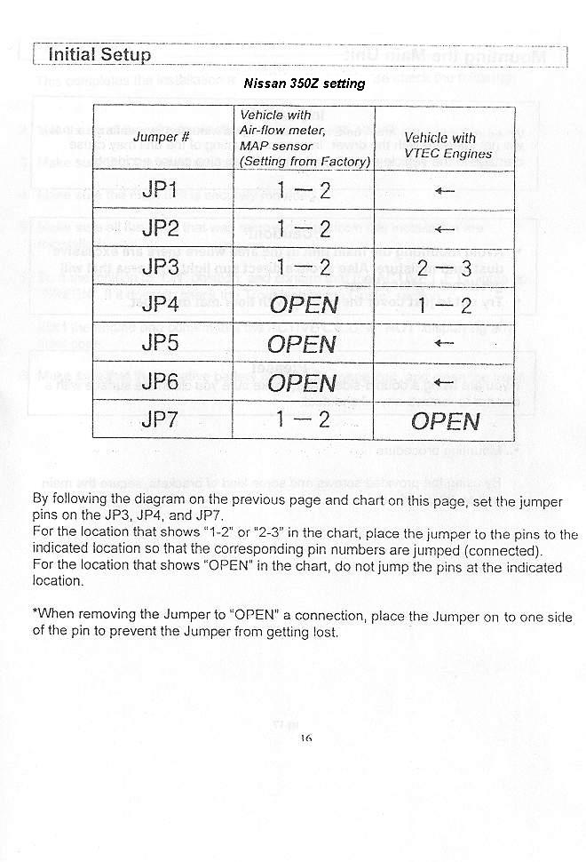

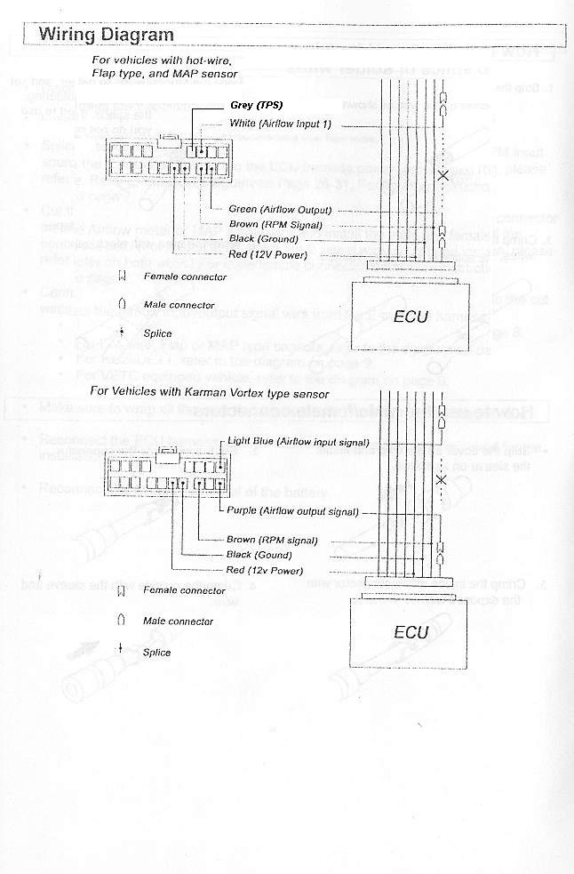

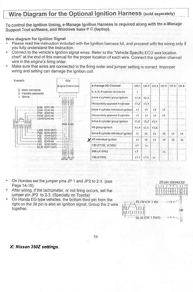

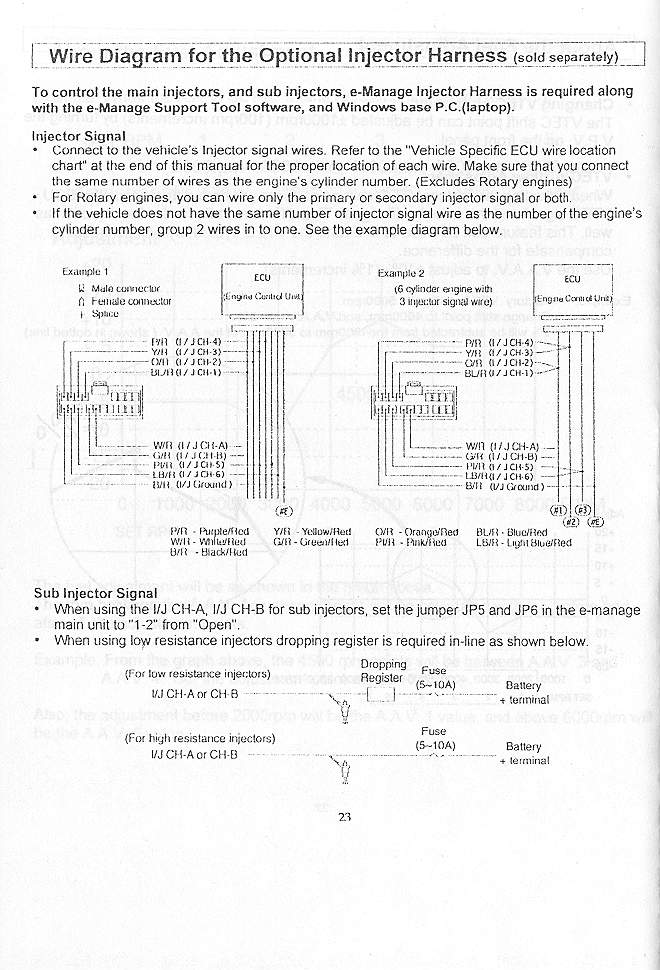

This also .... but you have to double check on the rotory switch setting .. it might be (7 0 B) with the new software update
