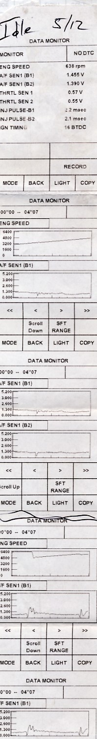

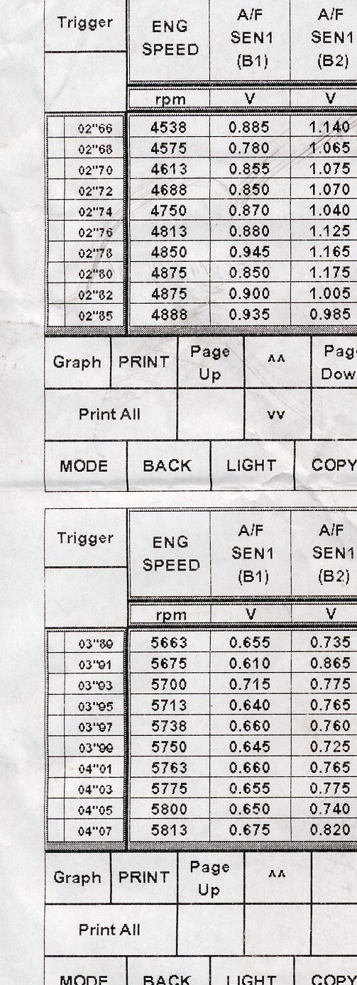

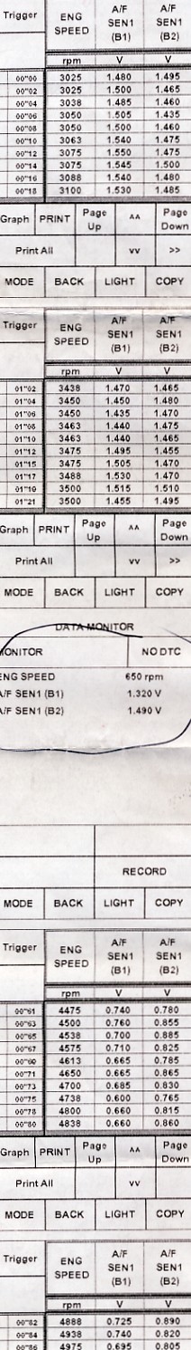

Thanks for posting your log~ It looks like we have similar mods. So I was checking out your WB Bank 1/2 voltages & AFR's. Looks like they're never quite in synch and sometimes the difference spikes by as much as .3 volts (which only translates to about .7 of an AFR point). Mine does this too according to my Consult II logs. It doesn't seem to be a big deal as long as the AFR's are not too lean.

Hi~ I was only validating Bank 1/2 AFR's on this run... Sorry, we didn't log timing... and the Consult II only has the capability to log in 10 sec intervals (weak sauce)... But here's what we logged RPM/ AFR's...
