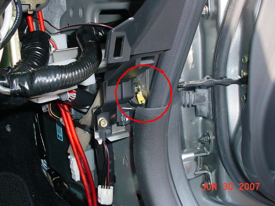

Or you could log into your UTEC and run some logs of the Knock Events you're refering too. If you're confident it's real knock, then either richen up the fuel maps a little for those load points/ RPMs and/or pull the timing back a little.... Assuming you don't have mechanical problems, that should take care of it.... Always tune in small increments. and try to tune one parameter at a time. That way you can put it back easily if the changes don't work so great.
Also don't forget to verify your grounding... The original shop that did my UTEC install grounded it to the underside of the dashboard mount by wrapping the bare wire around a grometized mount... Shoddy... The ground fluctuated according to my ohm meter during road testing...
So I crimped a connector to the ground wire and relocated it to the chassis per TXS. And also ran a dedicated ground for my ECU here as well... Now it reads a solid consistent ground.
High RPM 'stutter' is indicative of a bad/ fluctuating UTEC ground.
Attached Thumbnails Rev up owners w/utecs please help !-dsc02002.jpg
