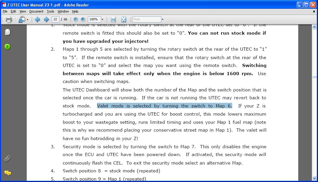

Map 0 = Factory ECU Stock Mode
Maps 1~5 = Map Spaces
Map 6 = Valet (Reduced timing + Map 1 fuel values)
Map 7 = Disables Engine Completely
Map 8 = Factory ECU Stock Mode (Map 0 Repeated)
Map 9 = (Map 1 Repeated)

Thanks im going to try MAPS 1-5
