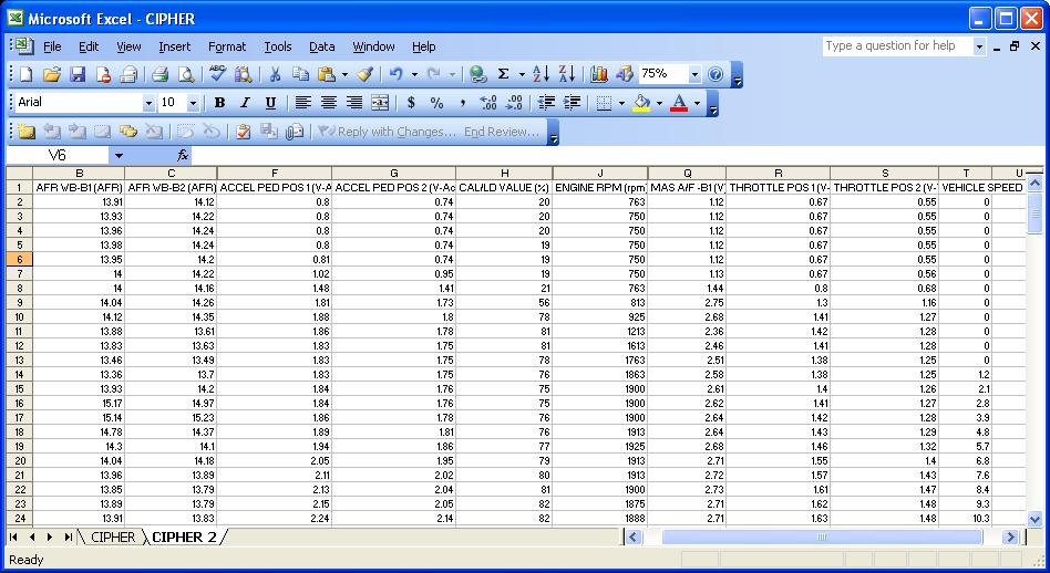

Adam,
I did a log last night. I think you're fine. I'm also at 19~20% Calc Load at idle. See attached log.
Erin

Old Oct 7, 2008 | 08:00 AM
Z1 Performance's Avatar
Z1 Performance
Former Sponsor
iTrader: (564)
Posts: 19,266
From: Long Island, New York
thanks Erin
