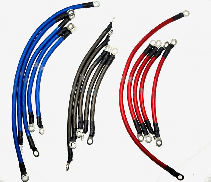

And this is very close to the classic topic of: "Do I need a grounding kit???"
HAHAHA
