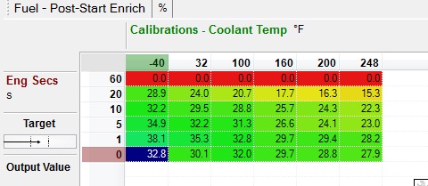

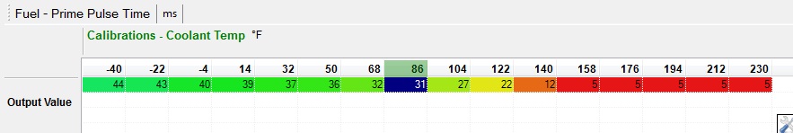

Prime pulse: THE prime pulse. Prime means first therefore the first injection pulse. if it's cold you probably need more fuel, if hot you probably need less fuel. That is the first place to start. If it cranks and doesn't fire up then your prime pulse probably needs to be higher when it's cold. If it's a hot engine and you crank and it doesn't fire for a long time then reduce the prime pulse because it's flooding the system. With large injectors the prime pulse gets pretty small. I mine is down in the single digits.
Post start enrichment: as soon as the car fires just 1 time this is what goes into account. If you look at the setup it starts at 1 second, so 1 second after it fires it is going to use that enrichment, then it goes to whatever you have it. I have 1, then 5 seconds, then 10 seconds, then 20 seconds then 60 seconds after start. Pretty simple setup actually.
cranking enrichment: enrichment during cranking (as the name states). I never messed with this because it's not as important as the others. So even with 1000cc injectors i didn't have to mess iwth my cranking enrichment.
the tables are in the help section of your ecu manager.

Post start enrichment. If you said it's rich then your post start enrich is to rich in those cell areas. You mentioned it started fine at 48* today so that means that temperature cell is good.
You are doing the right thing where you get haltech loaded and connected then fire it up while watching post start enrich. Look at the cell it starts in and watch the tracer. If you fire it up and it's rich or it just dies then pull fuel in those cells and start over.
If the car actually FIRES then your prime pulse is fine. If your prime pulse is too rich or too lean then the car will crank and crank and not fire up. Sometimes it will attempt to fire but not even make it to the point of starting. That's prime pulse. It's only a SINGLE PULSE of fuel. Generally when it's cold you will have a good amount of numbers and when it's warm they will be small.
My post start enrich is set so the first 10 seconds or so i'm idling in the 10's and then it slowly goes to 14.5 which is my idle target. I've never had a problem with my car stalling or dying after it starts. Until i messed with prime pulse time my car would crank for quite a while before starting but now it cranks over and starts instantly. Took me a lot of going back and forth adjusting the prime pulse time by 1 point up or down and noting how well it fired up. You can continually do this for one sell if you shut the car down right after it fires up. The engine doesn't heat up too much after just firing.
I never touched my cranking inj. Leave that beast alone.
You can see how hard my prime pulse drops off as the temps increase in order for my car to fire right up when i turn the key.
Attached Thumbnails haltech: cold and hot start issues-post_enrich.jpg   haltech: cold and hot start issues-prime_pulse.jpg
