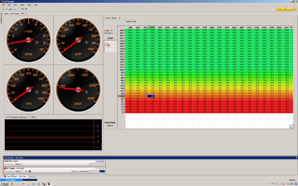

Heres one:
I'm going to get more screenshots by playing back the logfile and screencapping that in a few places. But you can see the AFRs have stabilized a bit.

The 40kpa now makes more sense, it is absolute vs relative to atmospheric pressure.
So your vacuum is around -20inhg gauge pressure which is normal.
Idle seems high. Cipher only allows adjustment up to 900 rpm so that is probably not it.
Is your TB modified....like someone drilled a hole in the plate or adjusted the closed position causing a high idle? Did it idle that high with the FCON?
14.1 idle is not that bad, could still lean out some.
