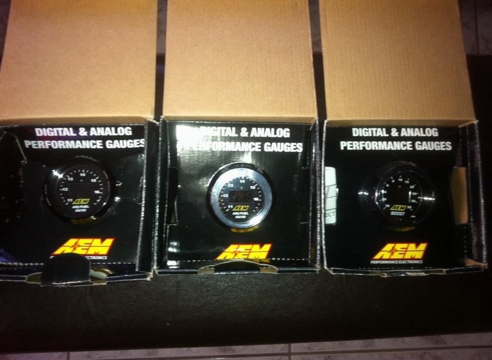

Thanks for the reply.
This are my actual gauges, I bought them for this project many years ago (since then project has been in pause, I got to move and so on) I don’t remember the actual gauge model to search for their specs, but I’m pretty sure they are not the top expensive ones.
The car used to start up just fine, problems comes when engine build temperature and then the A/F ratio goes crazy. The check engine light goes on also. We check for code and it saids “Misfire”
Also i can remember my tunner told me one engine bank sometimes receive too much gas.
We check the FRS, Gas Pump, Gas Regulator, Fuel Rails and everything was normal. I even change injectors for brand new ID 725CC and new injectors harness, but problem continues. This got me frustrated and I pause the project.
Now trying again to find a solution to this.
Any inputs appreciated.

Old Apr 13, 2020 | 01:03 PM
Conway_160's Avatar
Conway_160
Joined: Dec 2012
Posts: 2,593
Likes: 357
From: Pan Handle
It's a known problem with the OEM plenum that certain cylinders receive more air then the rest. If you do a little digging maybe @bealljk knows the vaules, but there is a table on here that shows how much to trim the fuel to compensate for the air.
I think most AEM Digital guages have a 5v output to connect to ECU's
Old Apr 13, 2020 | 04:55 PM
bealljk's Avatar
bealljk
Joined: Apr 2010
Posts: 6,510
Likes: 1,326
From: North Denver
Yea, the passenger side bank gets better airflow and thus runs a little leaner than the drivers side.
Yea - one of the pins on the AEM wideband gauges outputs a 0-5volt analog signal to the ECU (or logger) to determine a given AFR.
Do you have the LSU4.2 sensors or the LSU4.9 sensors. I bet you have the 4.2 which are calibrated from the factory.
I would figure out why they lose power ... I would peel back the wires and look for a cut/frayed wire.
