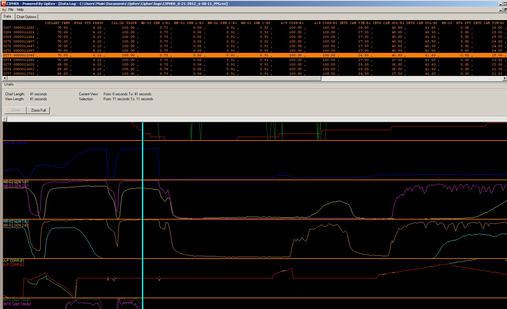

so, easier question maybe,
here is a quick log of my NB O2 sensors during a short pull. The upstream sensors follow pretty close, but the downstream ones seem way off. Wouldnt you expect them to overlay? I dont know what narrow band traces should look like though
My Proefi widebands overlay just fine
Attached Thumbnails Uprev: Params to log to determine P0171 P0172 cause?-nb-02-sensor-cipher-08-22-12.jpg

I thought by definition that a narrowband was only meant to provide two states, stoich or not?

I see you have a pretty big difference between upper and lower sensors, whatever is causing that could be part of the issue leading to your codes. Unless you have cats the upper and lower sensors should be reading the same...
(FYI, those codes are usually the result of closed loop corrections maxing out).
