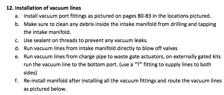

Hi,
As the title says. I need help from the people in the forum to install and routing the vacuum lines for the HKS EVC. could really use your help please. I have attached all the necessary files for you to view. I'm running a GTM stage 1 TT kit with internal wastegat and have routed the vacuum lines as instructed in the manual, but planning on installing the EVC and need help.
Attached Thumbnails Need Help in installing an HKS EVC 5-vacuum-lines.png   Need Help in installing an HKS EVC 5-instruction.png
