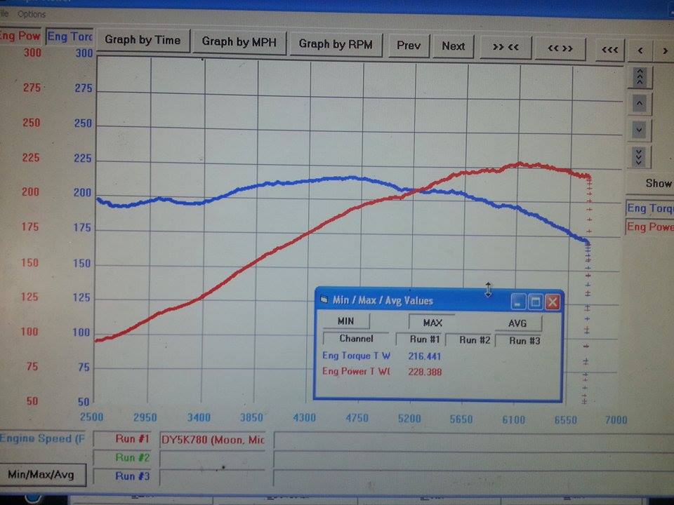

Here is a picture of the dyno graph how we left it, i had to get him to email me a picture because i lost my hard copy.
PRT is pretty good though, i think most if not all the z's and g's in dfw use him.
He said he had to be pretty conservative with my car because it didnt seem to like alot of timing.

that is around normal for your car, my car (08 HR) on the same dyno hit 286 hp

Okay awesome, i was having a hard time finding where my car is at because of the translation from mustang to dynojet. That's good to know. As for the knock sensor on decel im thinking it was just bad gas, shitty winter blend i bet. Who knows. If worse comes to worse i will replace the whole damn sensor/harness.

long tube will get you the most without tearing into motor... rumor mill has it that motordyne is going to make some. mustangs average 10-11% lower than dynojet, but remember it is just a number. if you want to see on a dynojet, call adm performance in lewisville.... they are mostly a chevy shop but i imagine they will let you do a couple pulls
