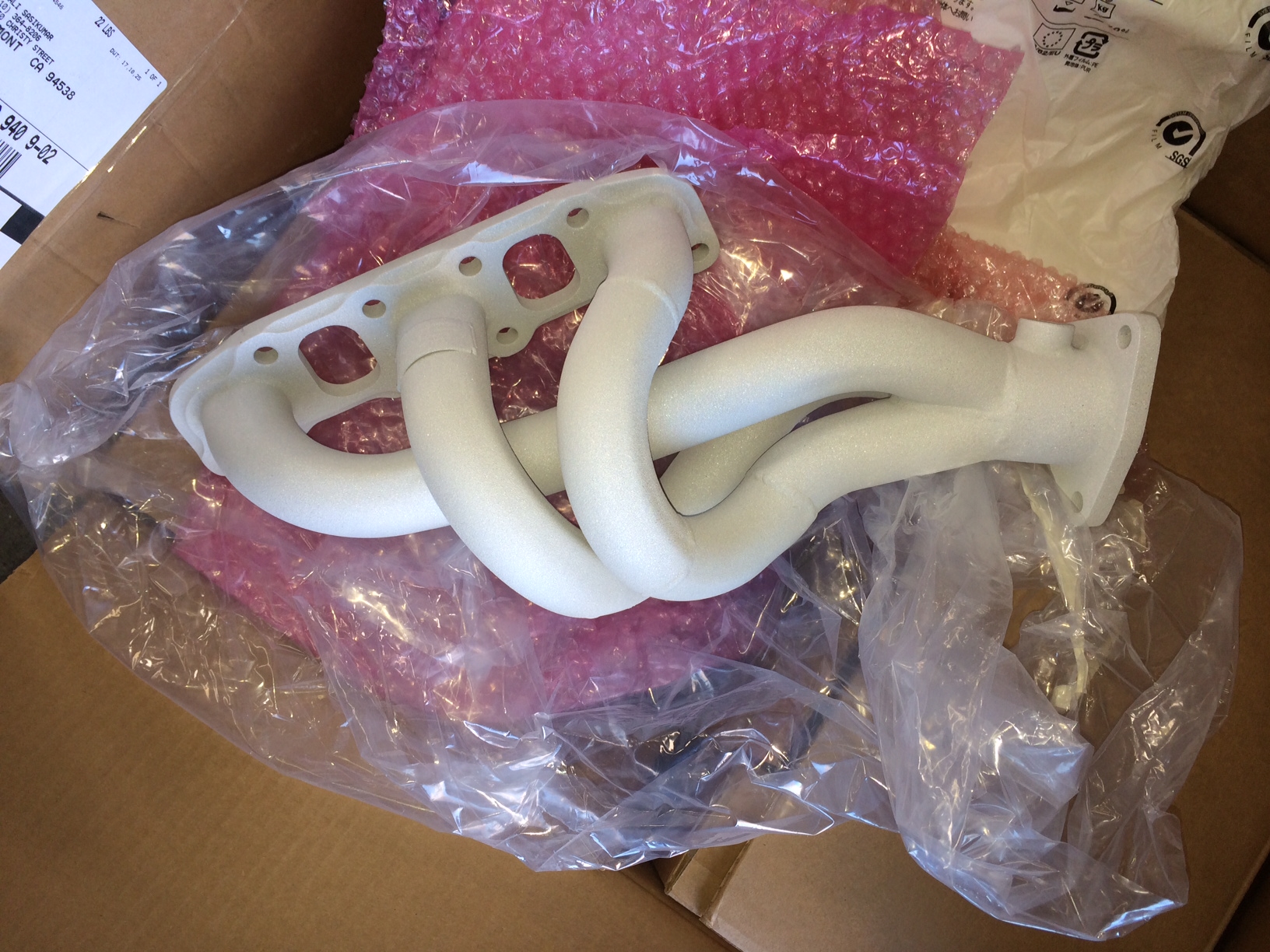

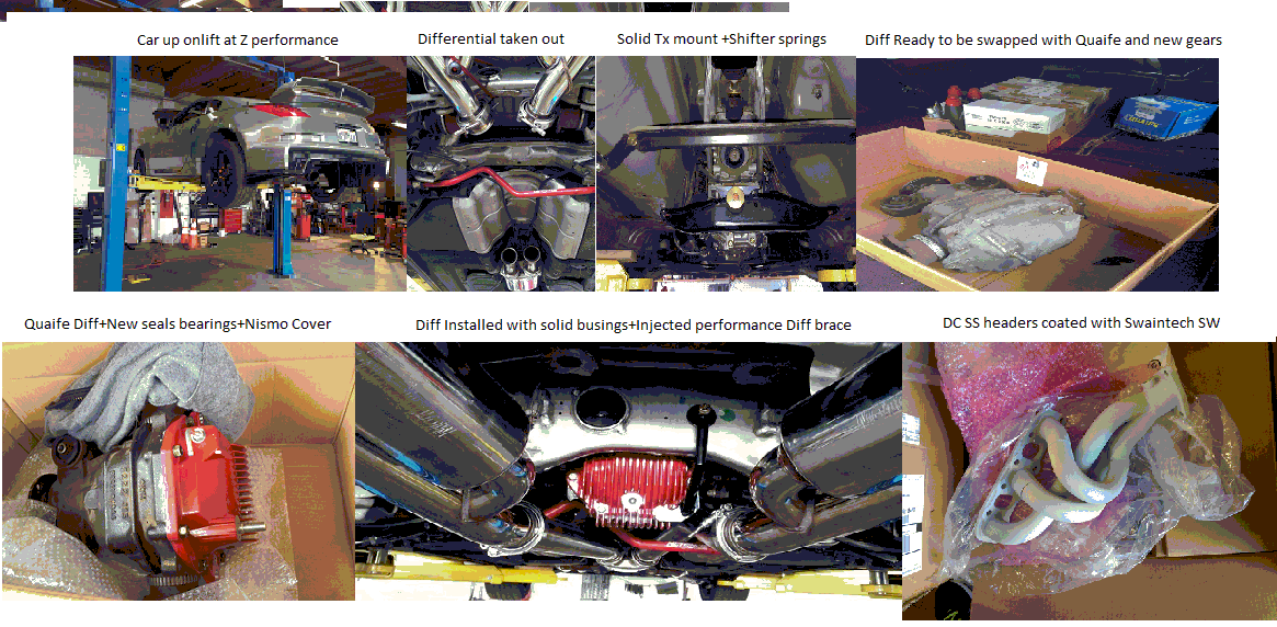

DC sports SS headers coated with swaitech snow coating
cross drilled and slit rotors
hawk tracK brake pads
ss brake lines

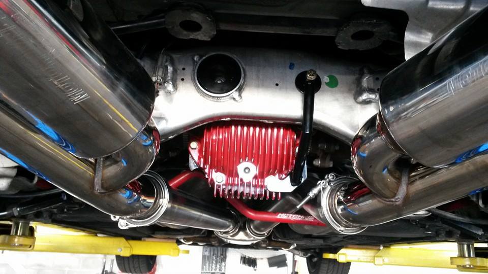

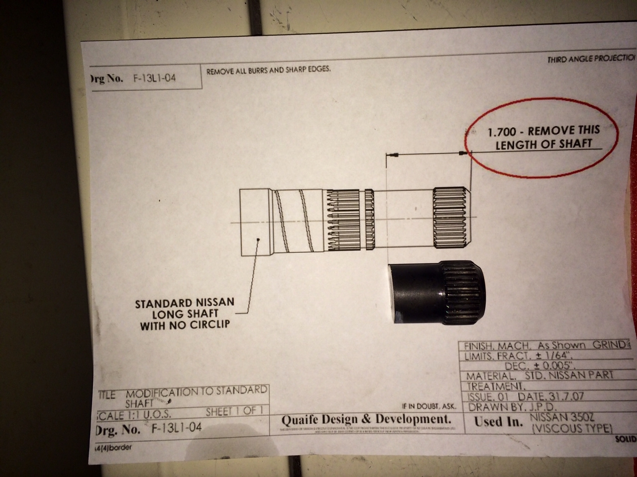

quaife diff
nismo diff cover
solid diff bushings
solid transmission mount
Injected performance diff brace
M-TECH Shift springs
