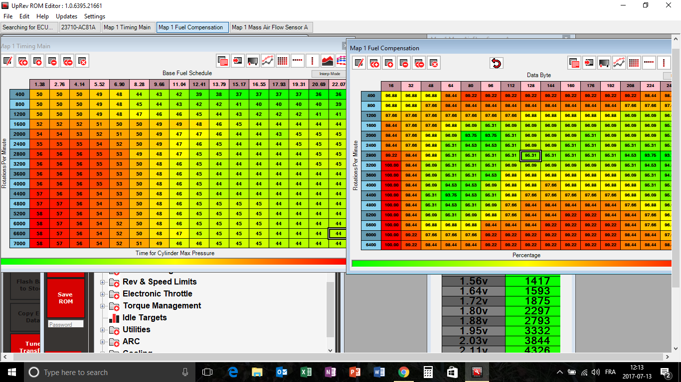

Hi,
When I look at the timing map on the internet/forums I see that my numbers are much lower than yours (about 44 vs 54). The car runs well except when the load rises very quickly, the timing falls to -10 and -7 for .5 second and it returns to normal and car pull strong again?!?!
I have an vq35de revup engine with ratio of 8.8:1, head stock. I changed the knock sensor and cams/crank sensor .. always the same timing problem that goes down when the load rises too fast.
What influences timing? Cam/crank sensor, maf and..?
This is my timing map
Sorry for my english..i hope you understand!
Thanks

Why my timing drop to negative value when high load come fast?

Check fueling. I had similar problem, it turned out that taking some fuel in MAF table put ignition values at the place.

Ok.. I think i need to do more fine tuning on my K fuel and Maf table to be sure base tune are perfect.. last time I wanted to datalogger my values (a/f, fuel corr., timing..), Uprev crashed everytime!? I'll retry..if not i'll check with Uprev.
