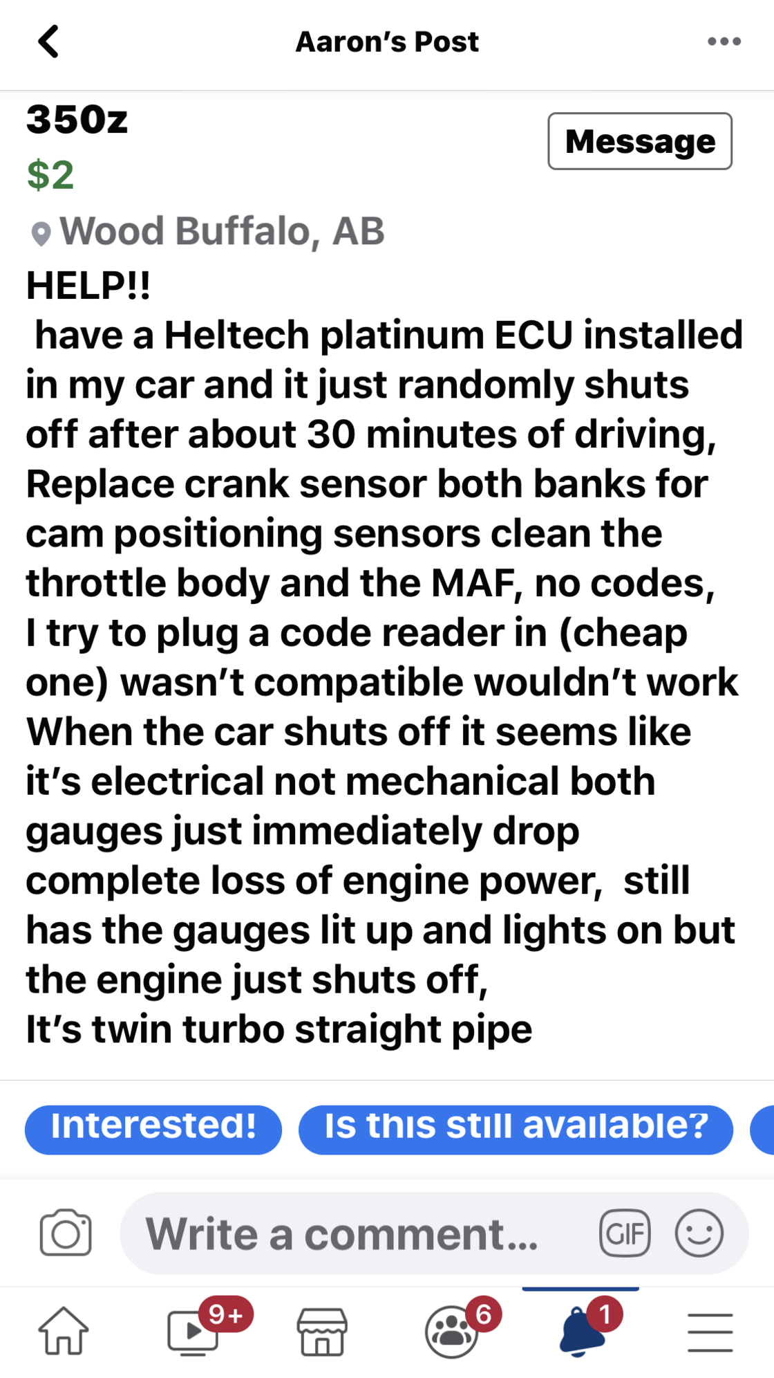

Thanks Conway. I’ll try out the .650 ms decel setting as soon as I get the car running again. I blew a wb o2. Reading full lean. Swapped sensor to opposite bank, problem followed.
now the car died out of the blue at red lights. And it seems that other guys with this ecu are having the same problems.
I went and purchased new oem crank angle sensor, exchanged all 4 oem cam sensors and refreshed the timing cover seals/orings. Installed c8 cams. Then when I was ready to test, o2 bank 2 died. Lol
I felt this guys pain a few weeks ago. Seems like I wasn’t the only one.
