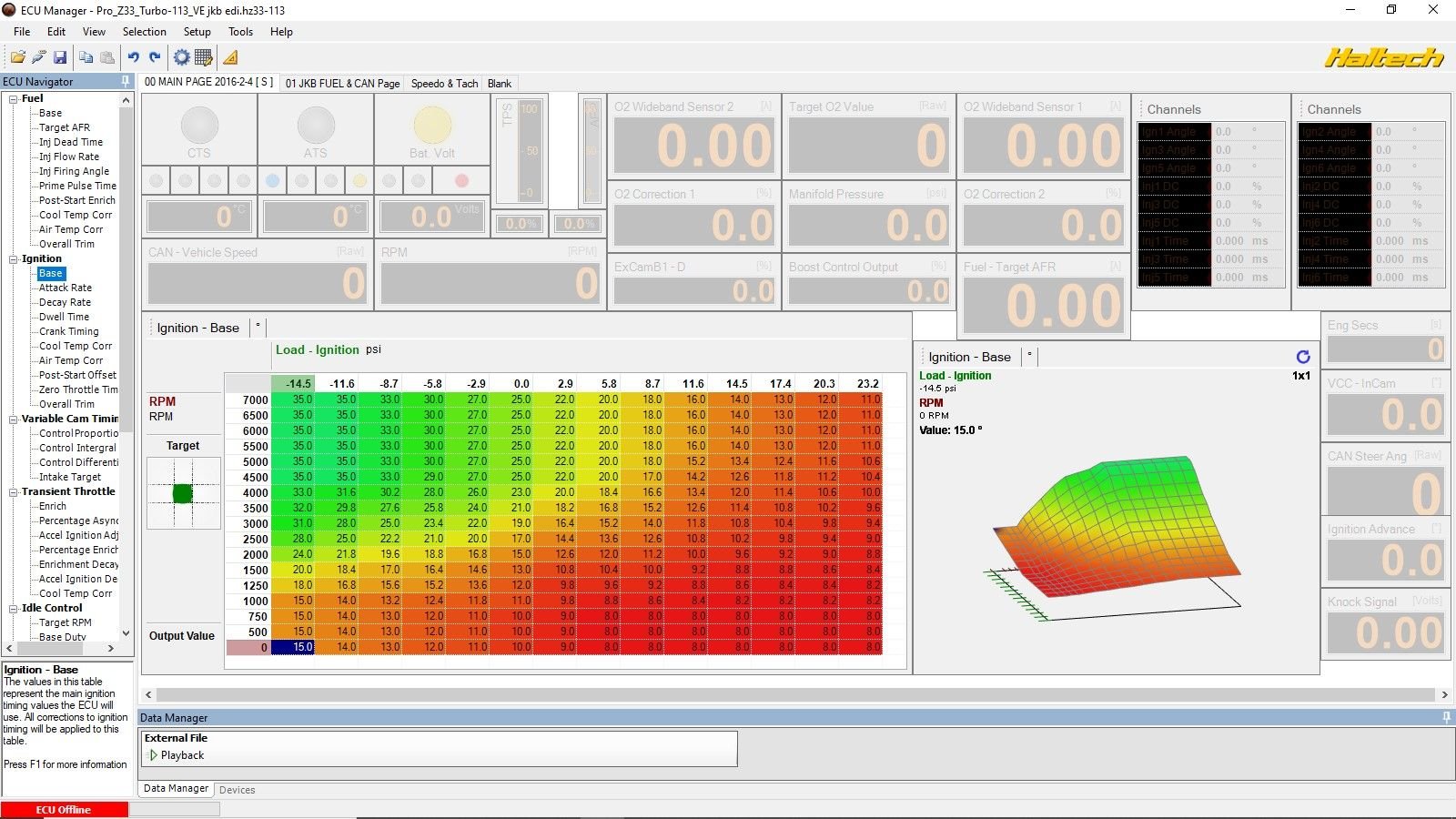

lets start easy … these are the home screens of each ECU.
This is Haltechs 'Home' screen. Link and Haltech are relatively the same. You have a tuning worksheet with menus and shortcuts towards the top and expandable menus to the left. Furthermore, both ECUs allow you to have 'tabs' for anything you like. Both ECUs are very customizable and these are just examples of mine. They are very very very configurable and you can have different styles of gauges, different ranges, and warning lights associated with each. Haltechs are easier to setup and I feel have more warning capabilities than the Link (but I am not 100% sure about this).
Haltech is far more simplified. Their menus are logically and easier to understand (I'll go into this more later). If you're new to tuning and want a very logical layout and function than Haltech is probably a better choice.
Haltech uses the bottom left corner for a 'help' section and does a mediocre job of explaining what each feature is used for. Link is universes better in both form and function. (more on this later - it's such a broad topic that I'll dedicate a post to this).
Haltech uses the very bottom portion of the worksheet for Data-Logging. Data Manager is the logging feature and this is where you do your data logging.

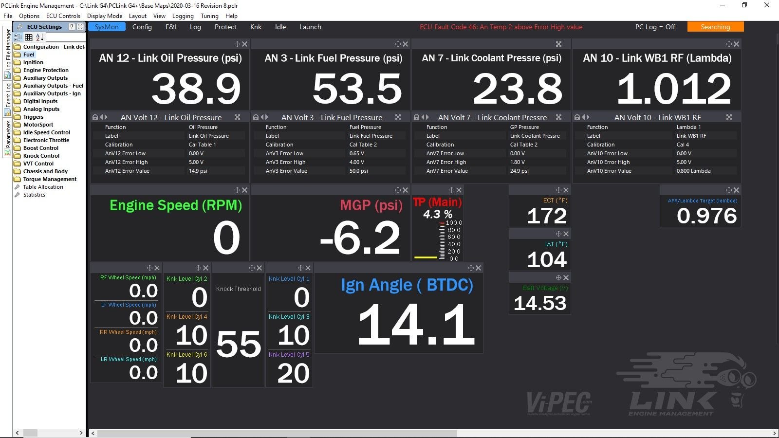

This is Links layout. Very similar to Haltech in that it has menus at the top and these are very comparable but are more in-depth and have more options and more tuning features. This is at a cost - Link has more features but is more complicated and you will need a more in-depth and tuning base knowledge to fully utilize these.
Link has similar menus on the left side but this particular setup has more features than the haltech. Furthermore, Haltech stores their setup menus in a different areas (they have a short-cut button that looks like a cog-gear to access their setup menus) while Link stores the setup menus in the same menus (on the left side) with their associated feature … meaning that anything setup related to fuel is under the fuel menu, along side the fuel tables (AFR target table, fuel comp tables, main fueling table, etc.). This is nice because if you are working on fuel setup you have both settings and tables to work with but it definitely makes things more complicated as you have to sort though different menus.
This is my system monitor tab. I typically keep this tab up when I am driving. It has the parameters I need to monitor the car while driving to monitor what the car is doing.
I use the F&I (fuel & ignition) when I am working with fuel and ignition, log to review data logs, Protect tab to monitor and setup my rescue sensors, Knk monitors my knock sensor and it's abilities, Idle tab to mess with my idle, and Launch is a tab I setup to dig into my launch control. Everything is very configurable. One huge thing I like about Link is that you can change the font size of menus. So you can make font smaller to add more things to the same amount of screen space. I don't think Haltech has this option.
One feature that I really like is that Link will give you error codes (which are associated with the CEL light on the gauge cluster) when a user defined error occurs … you can see on the top of the screen in red, 'ECU Fault Code 46: AN Temp 2 above error high value' … it takes a little experience to work with but AN Temp 2 is my fuel temp sensor and I'm having an issue with its ground or power and the ECU is telling me that the sensor is reading outside of my defined setup, in-fact, I turned this sensor off until I can chase down this issue … but you can setup most sensors to flip the CEL on when a reading is outside of parameters you setup...so I can tell the CEL to come on if the fuel pressure drops below 51psi and I can almost instantaneously know this by knowing which AN (analog) sensor is listed.
This is fuel & ignition - very similar to what Haltech has but axis are opposite. I think there is an option to reverse them but I prefer them this way - this is mostly because what I have learned with HPA and their usage of their Link G4+. One thing that I appreciated when I jumped over to Link is that you can look at your Fuel and Ignition maps at the same time. With Haltech you can only look at one or the others (as dictated by what menu you are in).

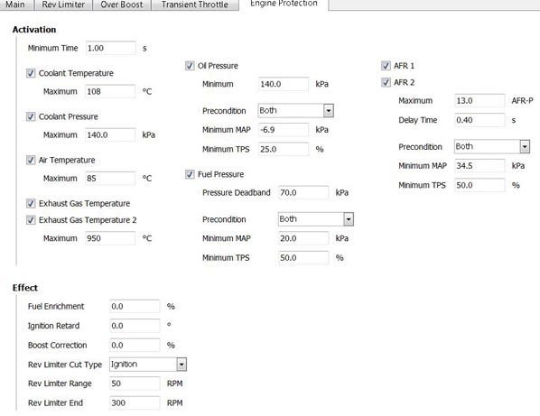

Yea - so Haltech has AFR protection built into the software with some user defined metrics. I don't completely understand what Haltech is saying … are they saying that if the AFR climbs above 13:1, and with a MAP of 34.5kpa, and a TP of 50% it does what?
I like what Link has because it gives you more options and more flexibility as to when to activate the protection. I don't care if my oil pressure is at 15psi, as long as I'm under 2000rpm … but if my oil pressure is 15psi at 6000rpm than I have a problem.
Also, AFR spikes to 30:1 when you lift off the throttle … which is completely normal, hence why my max is 5volts before it kicks into protection mode. So this safety feature is practically useless.
Here's a screenshot of how I have my Link setup.
#1 is on the right in the thinner red-lined box
#2 is on the left in the thicker red-lined box
