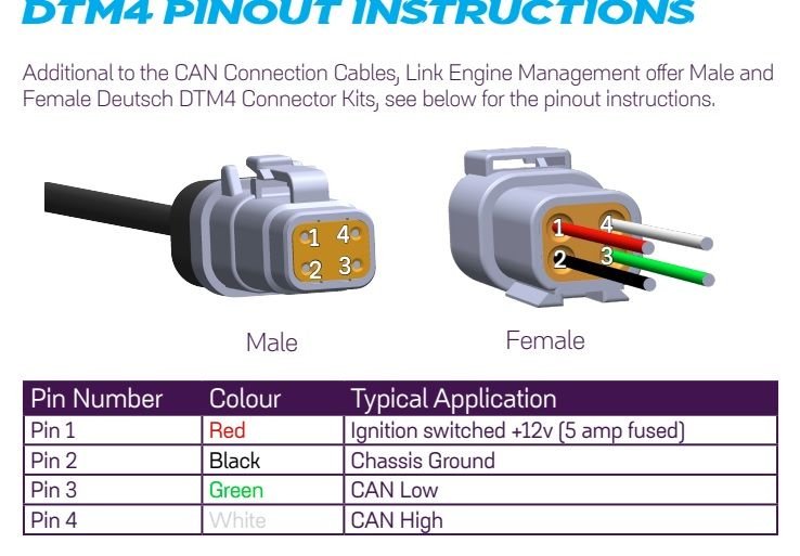

One thing though, is I didn't end up using the adapter with the orange wires (in your pic). There's are many ways to approach the wiring to connect the power/ground and the CAN high/low, but my approach was to replace the DTM connector that comes straight out of the controller. Then your Link adapter will plug straight in there.
Alternatively, if you wanted to keep the WB2 original, you could make a female-female cable to sit in between. Probably smarter but more cost, cabling and bulk.
Remember to double check your pin positions. Thankfully Haltech and Link share (basically) the same colours:

For ref, this is the one from the Link PDF,
