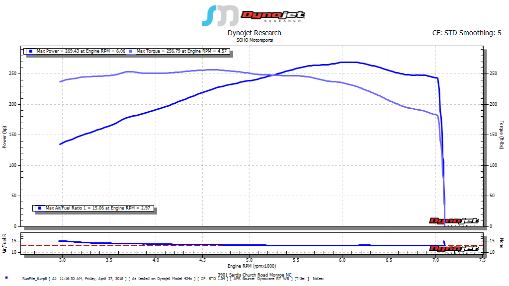

Nice. It sounds like we have similar mods. On my '05 I've got the Admin intake, 75mm TB, Z1 angled plenum spacer, stock headers, Berk HFCs, and the TDX2. Here's a shot of my dyno results from about 4 years ago.

Man thats a good looking graph! Area under the curve looks really nice...i hope i can get close to that. Was the driving difference after the tune noticeable?

The immediate noticeable difference to me was the throttle response. Prior to the tune, I changed out my clutch and flywheel to the JWT lightweight flywheel/clutch combo. Maybe it's all in my head, but I felt like the tune really improved the throttle allowing it to rev faster taking advantage of the lightened flywheel and my other breather mods. I'm also running some LMGT4's which are lighter than the heavy stockers. Again, it all may be psychological, but I really enjoyed the drive back after the tune. I've also got an '06 G35 which is not tuned and I can notice a discernible difference in the throttle when driving the two.

I bet with the tune and your clutch/flywheel combo that she is spinning up quickly! Did you do that install yourself? 270 HP to wheels is a nice number for this car so im sure yours is performing beautifully.

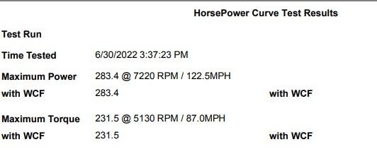

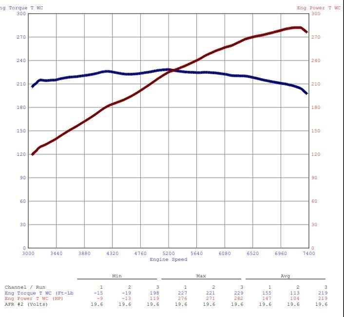

Default 07 on a Mustang Dyno
Nismo Intakes, Headers, HFC, Stillen Exhaust,
Thoughts?

Looks like good numbers! What were the before tune numbers?

Numbers look good, but torque is a bit lackluster, but I'm also used to DEs that put out 240-260 tq.

242 rwhp
211 tq
this is all on a mustang dyno that read 10-12% lower than dynojet
