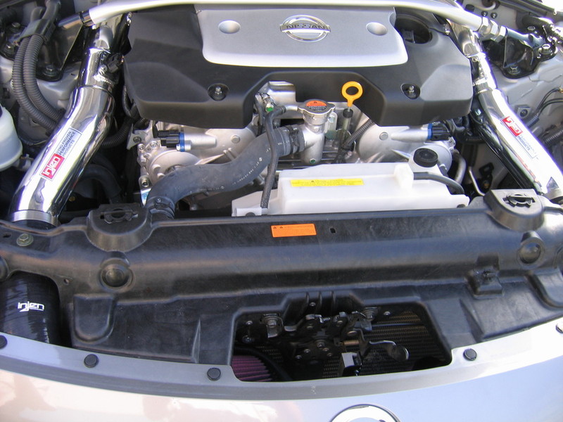

Default Injen COLD air intakes
Anyone see these before?
Someone posted this picture at another 350Z site. I searched here and in the intake/exhaust forum, but could not find any mention of it. If not, is it a photoshop?

i would guess its a custom job. i also would guess that it didnt gain based on the ridiculous angle to the filter
that is not necessarily true because AIR travels through STATIC not FLOW

travel and static arent words that describe the same action, you should explain further
