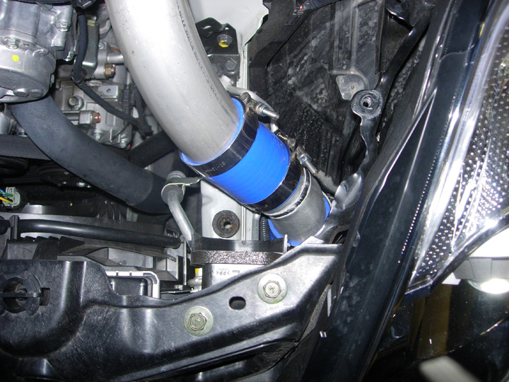

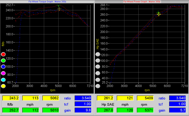

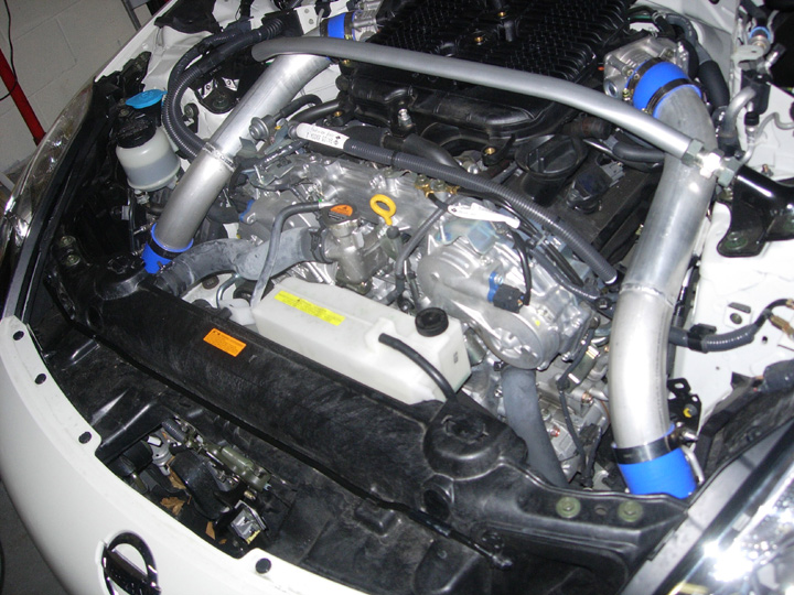

So, I have been in the creative lab working on a few things. One of which was a Cold Air Intake for my 07 350z. Thanks to our fabricator he made it happen pretty quickly. I figured it would work well with the next few rounds of modifications. I didn't expect any gains what-so-ever. Turns out there is some power to be found with an intake. Which is pretty impressive since basically you have no ram air effect on the dyno like you would on the road.
We put it on our Dynapack saw a 9.6 ft lbs. gain and 5.6 hp! A nice bump in horsepower throughout the RPM band. I am not done, I want to play with a few different air filters. Eh, enough with my BS…
Take a look!
Jermaine~

i'm very impressed with your work. however, i'm interested in how you gained ~10 ft-lbs with that setup. our enginers are completely covered underneath (if i'm mistaken please let me know), and the mini ducts in front of the stock airboxes is all i see where the freshest air can come from.
in summary, could you enlighten me with more detail to your setup?

Nismo, Fujita & AEM, are more or less the same type of intake. All their designs sacrifice the closed air box design drawing in air from outside the engine bay for a larger filter surface area, drawing in air inside the engine bay. Nismo & AEM "heat shields" hardly isolate the filter media from engine bay heat. All the intakes out thus far promote "higher flow" design, by trying to increase filter surface area, and diameter of intake piping, without taking into consideration how much less flow is actually required on 1 bank of the engine versus both. The one by BlackTuner is indeed a REAL cold air setup.
My question to BlackTuner is, are the filters in the fender wells like the older DE AEM/Nismo cold air intakes? Also, if I'm reading the dyno correctly, it does look like the cold air setup creates more power throughout the entire powerband except near the very end?
