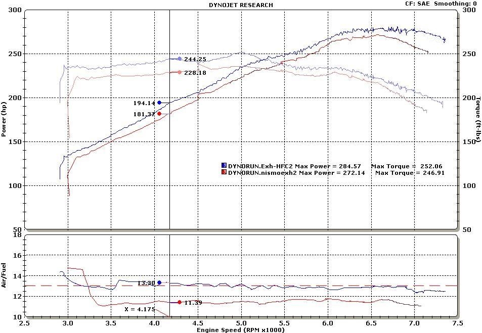

2007
350z - vq35hr - manual - nismo lsd - stock intakes and filters
base line
nismo exhaust
then
nismo exhaust + Berk Metalic HFC's
Second run on both
Dyno jet - 78 degress
I was surprised by the A/F going from 11 ish to 13 ish. I have been talking about the results so I finaly got them from the shop.

Is this to lean or right on the money? I have heard the 13 is just right for N/A. My 05 z would start at 13 and then go to 10 ish @ 6400 rpms

12.9-13.1 is a good afr for an n/a car

Those are great results! Looks like a solid 15 to about 20hp gain at 7000+. Thats got to feel great up top.

Yea the nismo does sound totaly different. I am still on the fence about the sound. Some days i like it other i dont. The dyno video is in the media section. I think i posted it here as well.
The car feels so much better.
Now with the AF already at 13 would a tune do anything? I guess keeping the TB open would help the top end. You can see them shuting and the fuel getting richer on the dyno after 7000.
