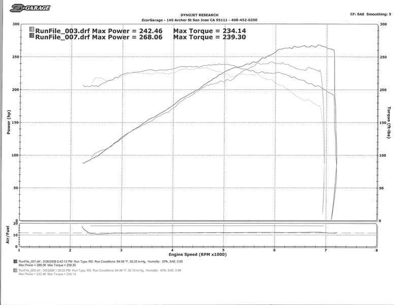

This is a fun thread. I wanna play...
Here is a dyno from my stock 07 HR against my wife's modded 06 rev-up. The rev-up has the MREV2 Lower collector and 5/16ths spacer which raised the tq about 18 lb-ft in certain areas of the curve.
Look past the peak numbers that noobs get fixated on. Look at the area under the curve at the 6500RPM range - that's a 40hp/40tq difference.
lol at the poster who mentioned no plenum spacer available for the 07+. It does not need one and you can spend your $$ on something else. the radical slope of the 03-06 hoods limited space and the intake plenum was shaped to match so the two front cylinders don't get enough air withour a spacer.
Also the HR has dual knock sensors and hot return coolant from the engine is routed in a metal conduit OUTSIDE from back the engine block to the radiator versus the revup whose hot coolant return passage was inside the block - lame. The rev-up is also a ping monster even running premium fuel (I owned two and they both did it.

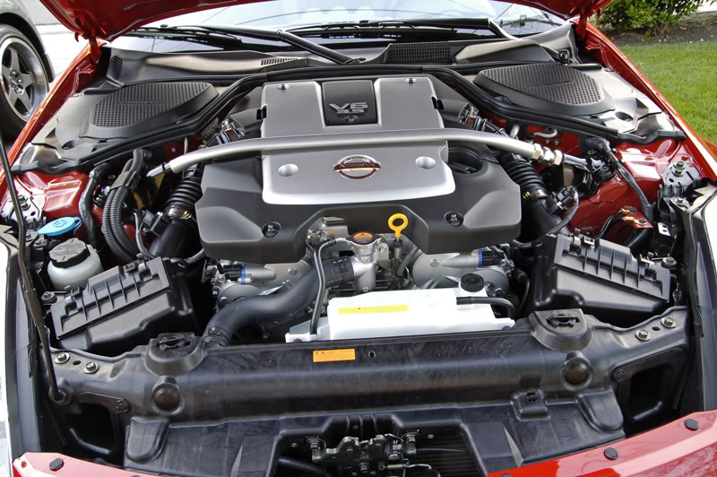

And the final of all HR vs DE comapros is:
The oil dipstick is now front-and-center and fits into a tube that goes straight down to the oil pan. Yep, I can even find the hole in the dark. The oil dipstick in the DE is a royal PITA to use. go try one. it's hard to get the dipstick back into, and it also shares an oil return passage from the head to the oil pan so it takes about 10 mins for the oil to drain out of the head and down that passage so you can adequately check your oil without the entire dipstick gettin wet with oil all the way up.
The DE engine series was designed to be tranversely mounted in an engine bay for a FWD configuration vehicle which they had to rotate 90-degrees to fit in the Z/G for RWD. That's why the intake and oil dipsticks are whacked.
So why would Nissan put an all-new (well, 80% new) engine in the z for its last two years? So they did not have to take a hit on their HP/TQ ratings under the new SAE rating systems. Nissan's dirty little secret.
