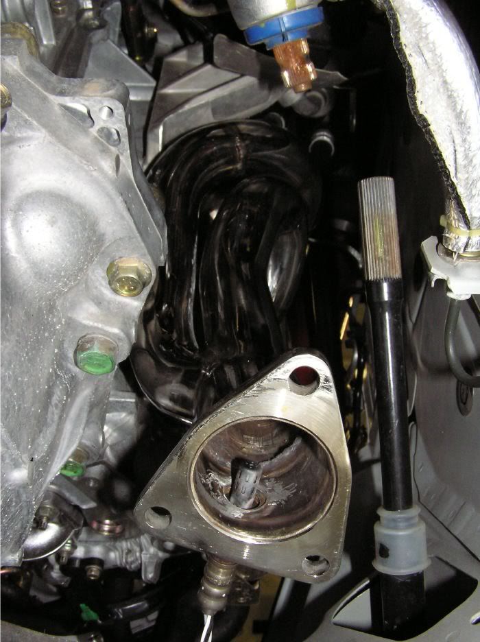

Okay on driver side... We have intake off and all, but the steering wheel bar is in the way of bolt, how did u guys get this bolt off?

you need a U joint.

Use this to let you angle the wrench up. Just did a buddies TP's a few weeks back and the steering rod was a tight fit.

This steering linkage?
a. Mark the buckle and linkage with paint
b. Remove buckle
c. Put it back together so the paint matches

It's stripped.. That's the problem..

Got it! Lol fhuker!
