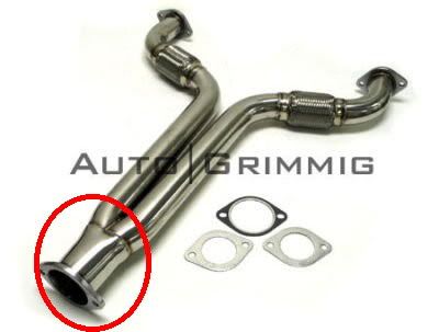

I think you got it. Kind of. This true dual exhaust never mixes exhaust from cylinders 1-3-5 with 2-4-6. There is no Y-pipe to combine the two sides.

Originally Posted by J123456
in the end, x,y,h or no pipes crossing at all, it is really depends on the company that made them. but true dual cat back exhaust is anything from the cat and down. if im wrong plz correct me
No. I will show this again with photo. Exhaust gas from cylinders 1-3-5 and 2-4-6 are combined here.
