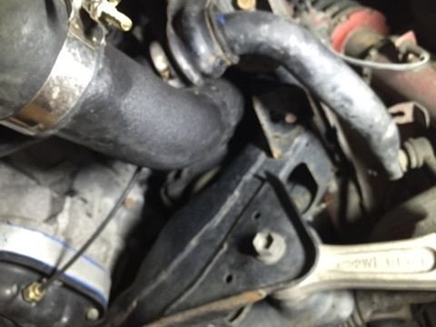

I had to run the piping under the sway bar because it is bigger sizes and not enough room to clear everything. Plus I have a misimoto radiator so it's thinker. W the bends and stuff being off it was easier to cut and weld a few prices together and get it to go under the sway bar at the mount and it's still high enough off the ground where clearance isn't a issue

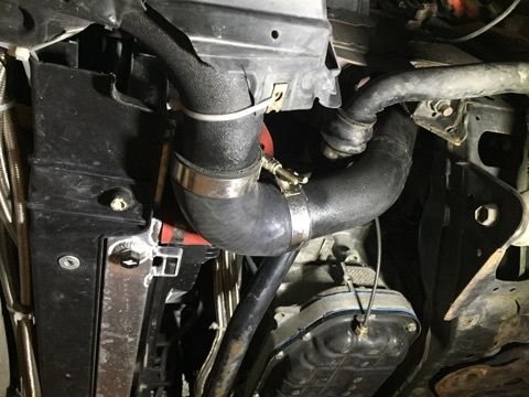

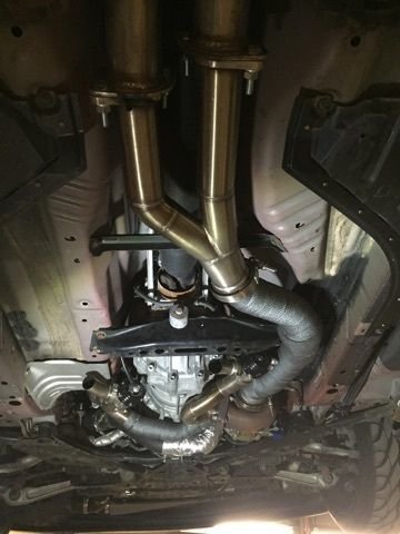

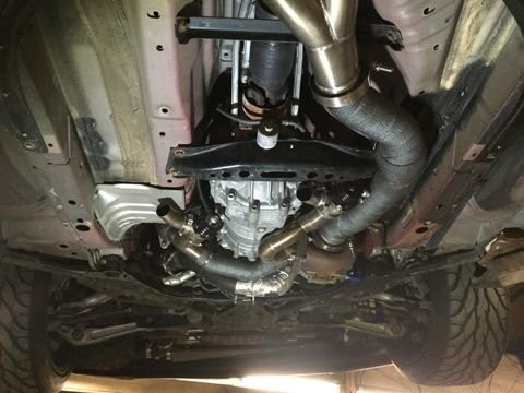

Can you take some pics of the from the turbo to the inter-cooler?
A picture is worth a thousand words.
I was looking at the area behind the crash bar and there seems to be plenty
room to fit 600+ rated inter-cooler.

Alright, I'm hoping to help answer a couple quick questions that have been mentioned here as I put this kit in with Doug.
First, the intercooler piping needed to go under the sway bar for two reasons. One being that the piping is wider in diameter, and in order to get it to fit it would have had very sharp turns along with lots of welding. By cutting and welding the pipe to fit under the sway bar directly below the pivot point, we were able to maintain a smooth bend in the pipe with little welding and easy to remove access in the future.
The boost controller on the haltech is setup using a 12 point AEM switch which we corresponded to a voltage output table for boost duty cycle. Lowest voltage is set at 5psi and then each voltage increase per click on the switch is 1psi of boost additional. Easy to setup in the haltech system, took all but five minutes.
The crash bar had to be removed with the intercooler, same as in my greddy on my de setup, the wide cooler needs the clearance on the mounts. There are plenty of chrome moly versions out there if that is a major for some.
As for all the hot side install, everything went flawless with the exception of the turbo mounting because of the frame rail. A little massaging and the 6766 fits in beautifully.
