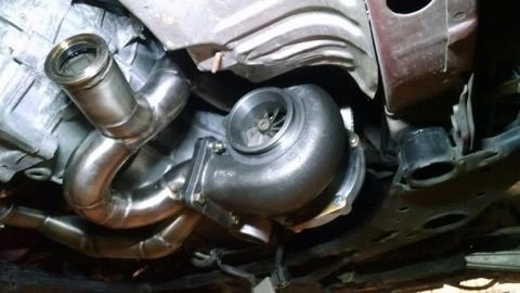

hi everyone
first i would like to thank Sasha at boosted performance .... Everyone at Dynosty and my close friends that helped
i purchased Sasha's single turbo kit for the 370z 67-66 precision turbo for my 2007 350z hr
This was no bolt up application as we thought it would be

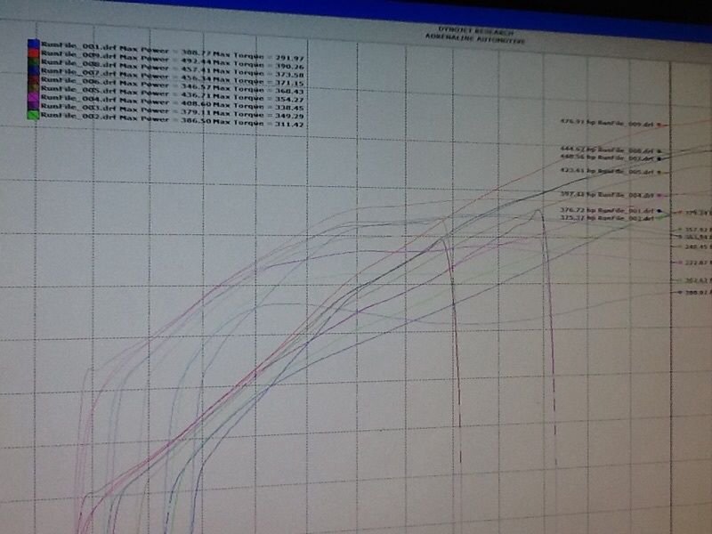

After modify a lot to get all the components in the car made some impressive numbers on only 10Ibs of boost on a stock block
Just shy of 500 hp with 400 ft-Ibs of torque
The car has 100k on it too
Im not using Uprev im actually using a Haltech Elite (DYNOSTY)

They don't I took boosted performance's kit for the 370 and made it fit lol. I have a ton I have to go threw but I will post up more pics soon

Look at how flat that torque curve is! I'll bet this thing is a blast to drive.

Man thats one beautiful curve. Nice numbers man. Also waiting to hear what mods had to be done to get it to fit. Will you be pushing it to get more power? or thats the max stock block will hold.
