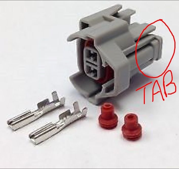

Tried pulling the injectors out today without taking the air intake plenum off, destroyed an entire connector housing trying to pull off the passanger side with needle noses, looks like im gonna have to get some different tools or take the plenum off in order to do this and more time, and also in need of a new connector housing now lol, still works though.

You only have to un plug the harness from the injector. Their is a tab on the connector, push it in and rock it back and forth and pull up. It doesn't take a lot of force. If you damaged the wires you will have to pull the upper plenum. Make sure you solder and shrink wrap the wires.

Yeah, is it one that you just squeeze and pull off? Or does the tab go in towards the the front of the connector where the connections are?

Harbor freight has the long handle long nose pliers the set was like $20. Get the pliers open, grab around the connector press the tab in and wiggle bac and forth. It pops right off.

Thanks for the tutorial much appreciated, will try to get this done this weekend, may see if i can get a long pair of pliers locally.
