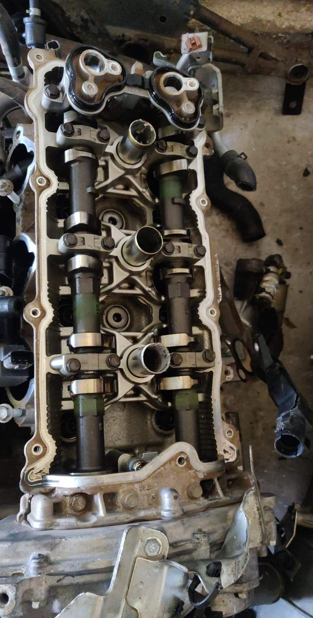

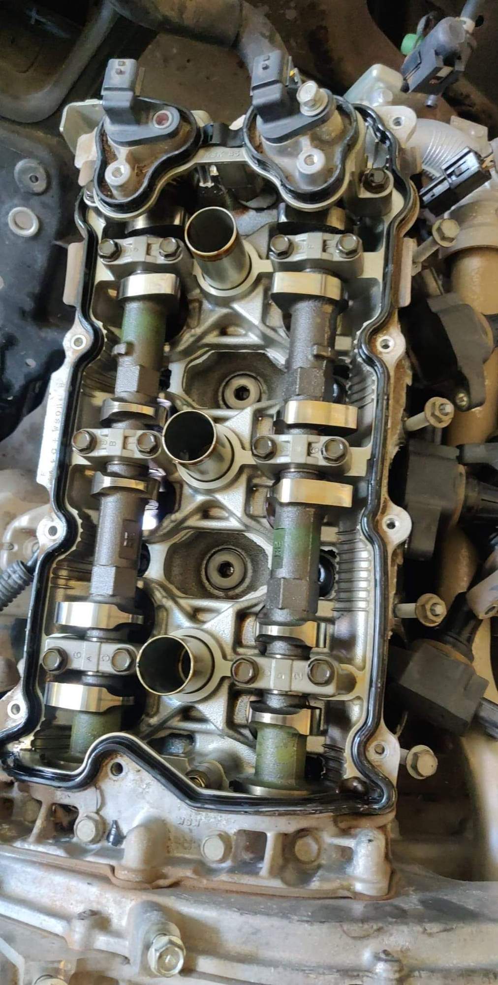

I paid 350 for hr engine
tranny harness and ecm I'm not too concerned with the power output I just want a newer platform and to be able to keep it Nissan I can swap the block out with a vhr block and have a little more fun with it in the future. This is a pic of the the engine it looks clean and I pulled off of a wrecked 08 z was stock and i also took the headlights and taillights off of it. Might do head gasket and timing chains and call it a day maybe new clutch as well I'm trying to keep this as budget friendly as I can though and guilty garage said de rack and pinion clears.
