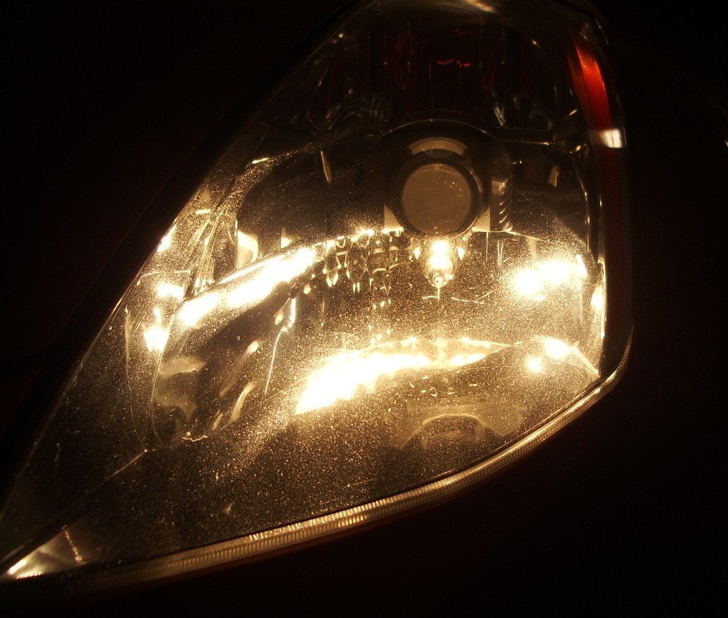

My HID's come on only under the following circumstances:
1. I turn my headlight switch to the full on position
2. I pull the light lever towards me to activate the high beam (which then activates both the full-strength DRL and the HID)
The DRL comes on at low-strength when the car is turned on and the parking brake lever is released. If you look at the DRL's from a certain angle, there is "some" reflection that may give you the impression that your HID's are also on ...but only if you look at it from that certain angle.
I've attached a pic of my car turned on, with the parking brake released and light switch not touched. Clearly you can see that it's only the lower DRL/high beam bulb (at low-strength) that's on.
I hope this helps.
I hope this helps.
^^^^ Thats the ticket!
