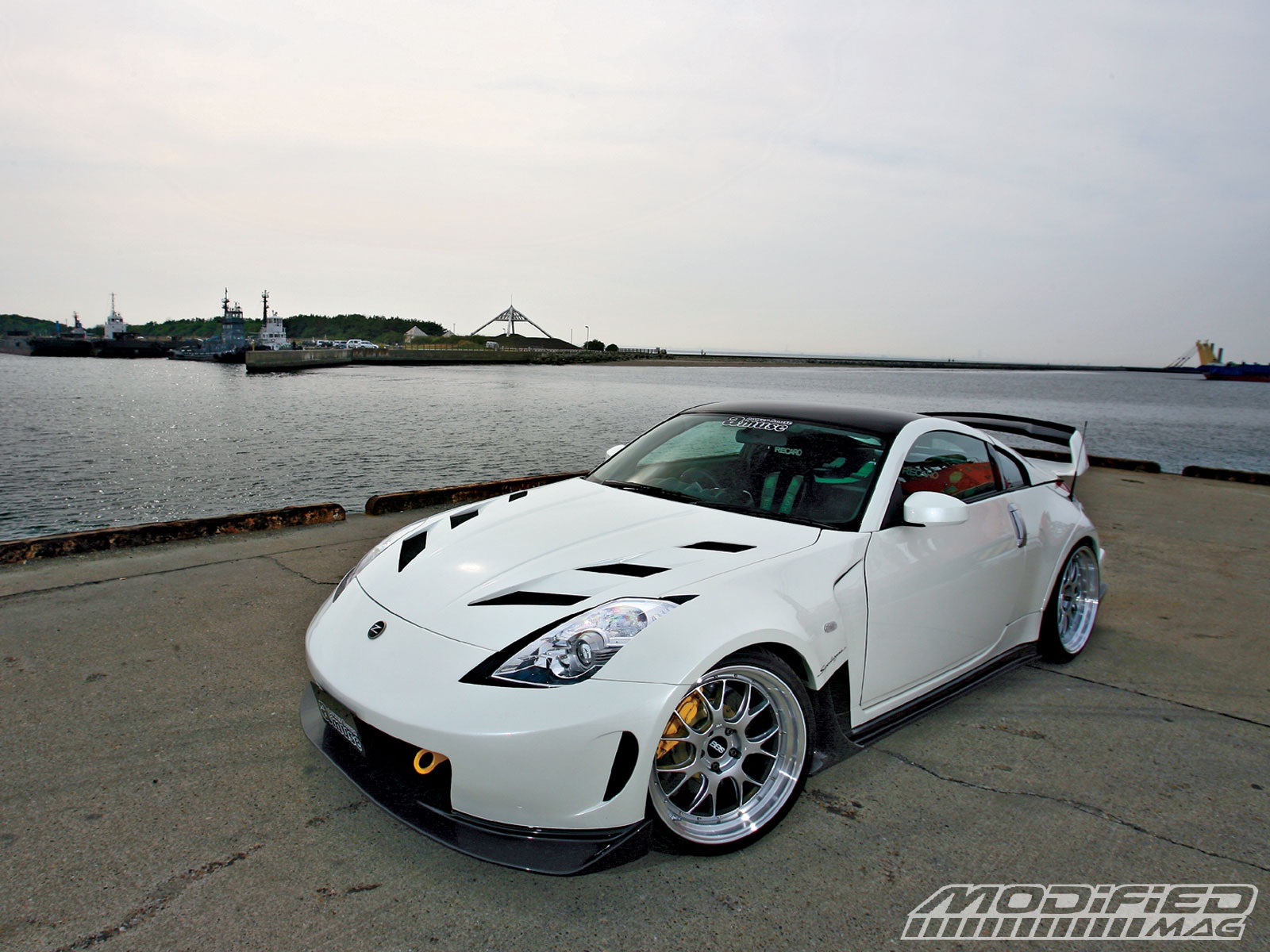

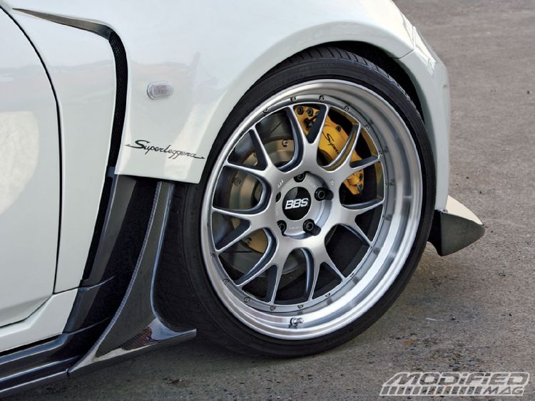

Hi.
This is my first time trying to change the rims and I need some good suggestions.
I will be very appreciate if anybody can help me to figure this out.
I am trying to change my rim sets like the pictures I uploaded.
The rims specs are the followings:
Wheels and Tires
Ericsson/BBS LM-R 20x9 +8 (f), 20x10 +18, Bridgestone Potenza RE050 255/30/20 (f), 285/30/20 (r), PCD changer
I found ESM 20 inch BBS replica set (ESM-004 20) on the forum.
and their specs are:
20x8.5 (35 or 20 off set) And 20x10.5 (40 or 25 offset.)
I know I will be required to roll my fenders but dont know how much I have to roll them, also the spacers, the tires and the offsets. I dont have any clues.
I know it could be a very newbie question but if anyone knows what to do, please help.
Thank you.

only sliiight rolling may be necc in the back...go w 20/25 offsets will be fine. 245 and 275 tires.

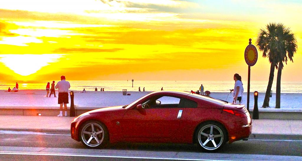

STANCE "SC5" High quality low pressure cast wheel. Prefer these over the Vossen CV3 because of the lip and also the spokes do not taper like on the Vossens.
20x10.5 Rear Plus 27 offset and 20x10 Front Plus 35 offset.
15MM hubcentric aluminum wheel spacer used on the front wheels to clear the Suspension arms.
Stock Brake Setup (non-brembo) and stock suspension.
