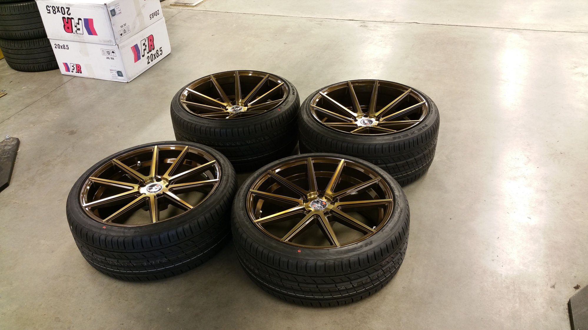

Hey Guys just got new wheels 20x9 +25 and 20X10.5 +30 what tire sizes would you guys recommend. Oh and I like the meaty tire look not Stretched.
255/30 front 285/30 rear

Thanks for your input Bud! 👍🏼 do you think 295/30/20 and 265/30/20 would be a bad idea?
I always like to match stock tire diameters. 255/30 and 285/30 match them perfectly. The sizes u are considering are gonna have a taller sidewall (larger diameter), combined with the larger wheel, will probably look too big. Besides, those tire sizes are rare which makes them expensive. Having had 20's on my z for several years, i would stick to the sizes i mentioned....

You know your stuff!!!thank you very much sir. I will definitely take your advise
