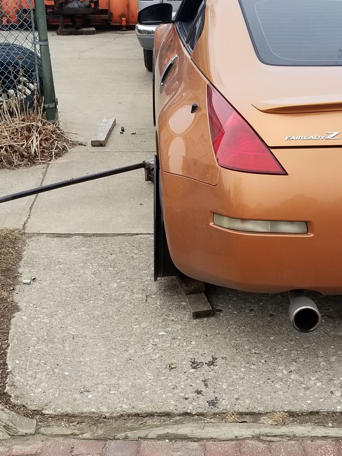

Originally Posted by Njohnson2294
With the above sized wheels, could I run 255/35 20 And 295/30 20 tires? Car is stock height and fenders not rolled. Pics of wheels.
Hi I was wondering what your offset was? I literally just bought a 350z today and I love the rolled fender, wide rims and slight tire stretch look. I know its not good for racing but I'm not a racer.
Old May 23, 2020 | 04:46 AM
  #1252
Njohnson2294's Avatar
Njohnson2294
Joined: Jul 2016
Posts: 11
From: Cleveland, Ohio
Honestly not sure.. will check and get back to you. Ended up having to roll fenders to run 295 30 20 in the rear and 255 30 20 in the front.

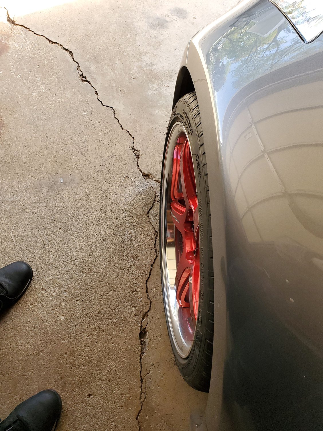

Originally Posted by DarkZ03
+45 is terrible but "should" fit. I would suggest selling and getting 19s it will ride better in every way. I have 9.5+25 and I wouldn't call it poke, only factory replacement shocks worth getting would be Bilstein.
Thanks @DarkZ03 for the feedback and for the pic.... It gives me a great idea on the 9.5 +25 (front). What you are running in the back or you are square? Can you throw a pic?
I will consider it but when you already have a huge investment on Tires Michelin iPS4 t is very difficult to sell everything. After doing more research i was confused with the standard offsets on the Vossen wheels. Our car uses low profile offsets so +20 / 25 should be the route.
Once again, Thanks...

No I'm staggered, with a 11+30 in the back
