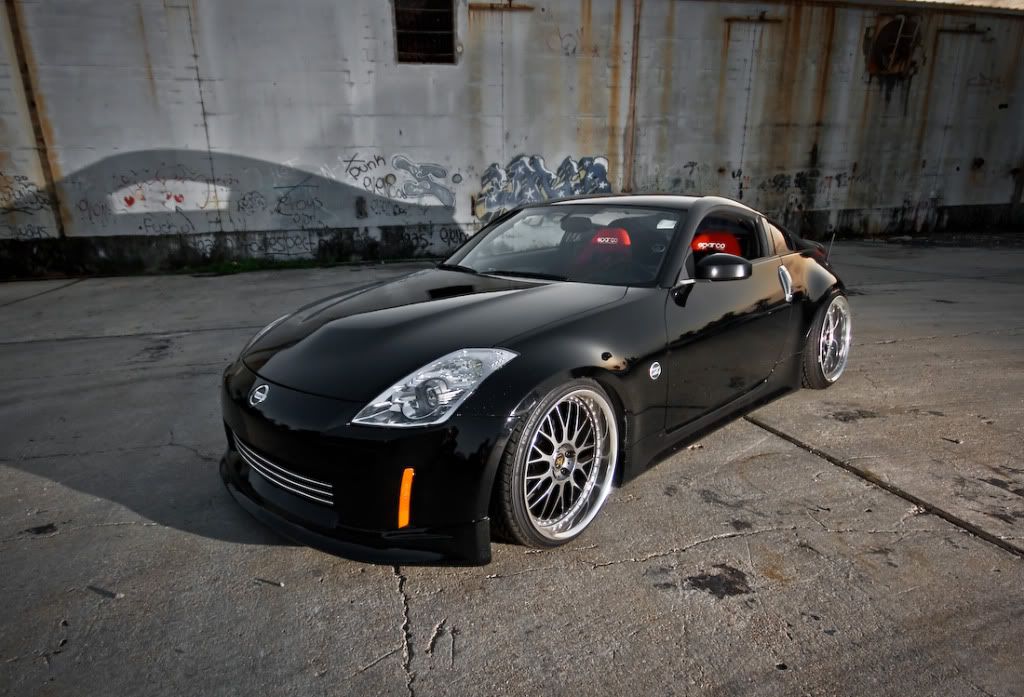

This is the only time I've ever seen 20s done right.
I would love to see more of this car.....any info?
this was the car that moved me to get my VSXX
looks amazing
Front rim size
20x9.5
Front rim offset
+8
Front tire size
P 245/30 R20
Wheel backspacing (testing)
5.56”
Rear rim size
20x11.0
Rear rim offset
+4
Rear tire size
P 285/30 R20
Wheel backspacing
6.16”
Rims brand
Work Wheels VS-XX
No spacers
- Fender inner lips cut, sanded down, and seams sealed
- Front camber -2.5 degrees, rear camber -3.0 degrees
- Cusco front camber arms
- SPC rear camber arms
- Stance coilovers
- No big brake
