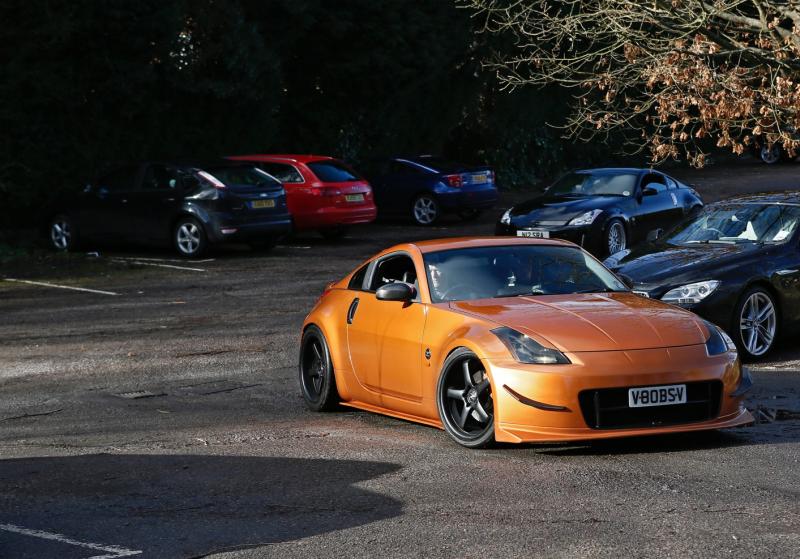

currently running 255/35/19 on a 9 with +10 offset front and 295/30/19 on a 10.5 with a +20 offset with the arches rolled.
