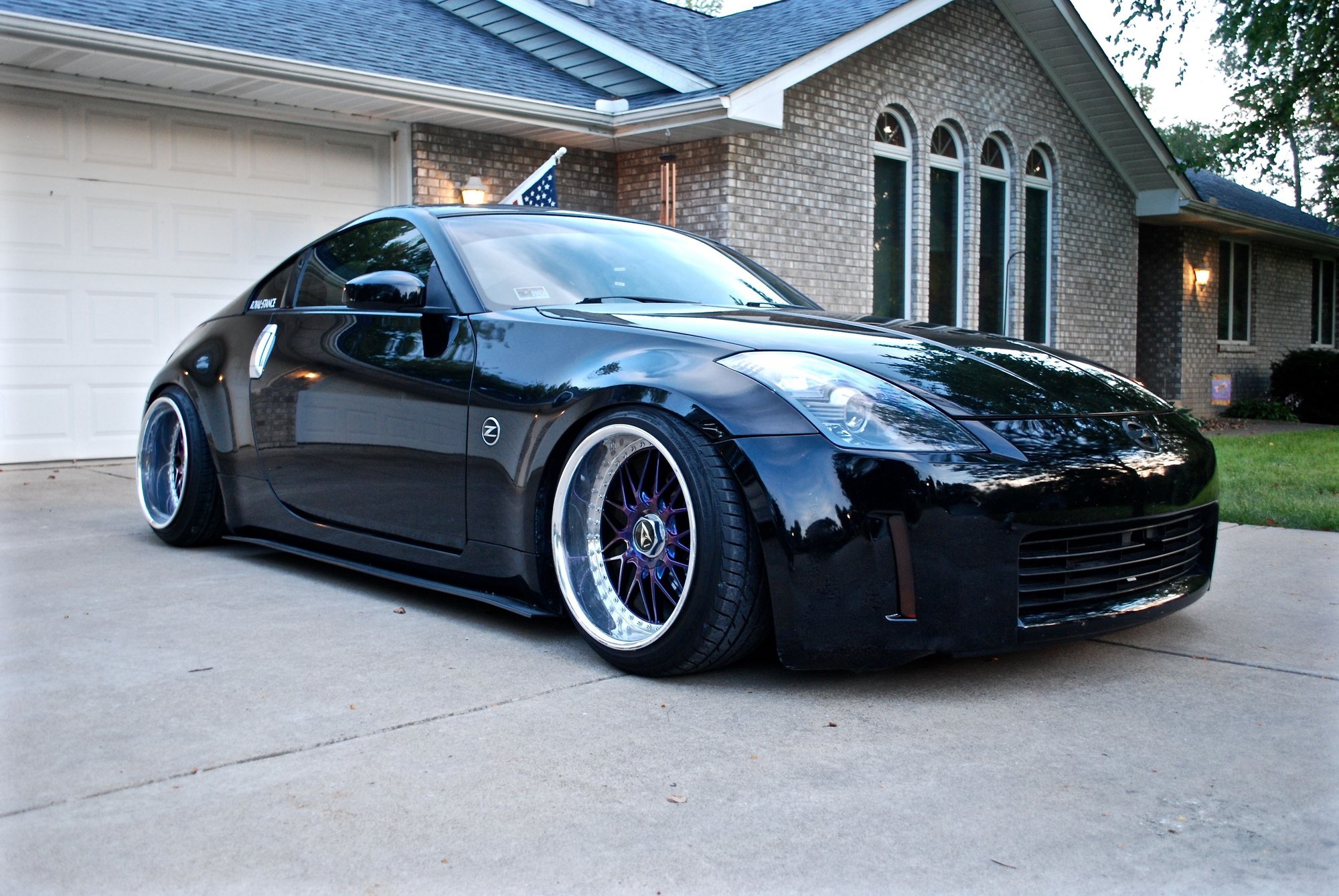

so I've been looking on the form for a while now and i haven't found any answers, so if you're gonna comment on how this has been answered or you can find the answer here or blah blah blah then, i really did try so if you're not commenting to be friendly and help then dont bother commenting at all please.. on that note:
i just ordered a set or 19x9.5+0 and 19x11+0 varrosten es2's for my 350z. i have Ksport coil overs, a fender roll/pull, and am currently running -3 camber in back and -1 in front. I came from the chicago suburbs where roads werent an issue but just moved away for college and need to raise the car a little and get some higher profile tires so these rims dont get dinged up liek my rezaxs unfortunately did.. so my question to you guys is this, what tire size would you guys run those rims (the es2's) to still keep the car low, but not have it as low as it is now. Im gonna raise the suspension up also so i should have a little more clearance i would think. so yeah, what would you guys recommend for a low look but just not as low as it is now. heres the car they're going on. if you need anymore info, just let me know.

If it were me, I'd see it 4 ways;
1. 245/40 and 275/35
2. 245/35 and 275/30
3. 255/40 and 285/35
4. 255/35 and 285/30
Personally, I like a wider tire setup not that stretch nonsense. If you have camber arms you'll have a little more play to work with. I'd probably going with option 2 because it's the safest bet for each direction and still within the 3%.

Depends on how high you are going to raise it up. I have the same offset and sizes on my ES6s and am running 235/35/19 and 255/35/19. I could have went with a 265 in the rear. I have yet to have an issue.
where are you from, and what are the roads like? see im from iowa, where we have potholes and unlevel roads etc. im not trying to avoid driving carefully, but theres instances around here where driving carefully still doesnt avoid slamming my subframe on the ground or having my tire rub while going over a small bump haha. and btw, is there tire stretch on your setup, if so how much? sorry im on my phone so i cant reeally tell.
None of those are within 3% and will all cause TCS/VCD and potential ABS problems
Let me properly redo your list
1 245/35 and 275/35
2. Same as above
3. 255/35 and 285/35
4. Same as above
5. 255/35 and 275/35 work great too.
265/30 and 285/30 will also work
Old Sep 28, 2015 | 04:54 PM

You are mounting relatively wide wheels, so I would go with the wider tires your wheels allow. I agree with terrasmak’s suggestion (terrasmak said¨”265/30 and 285/30 will also work”).
