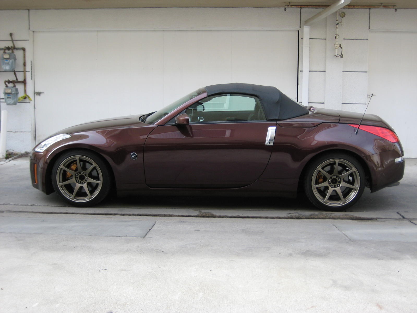

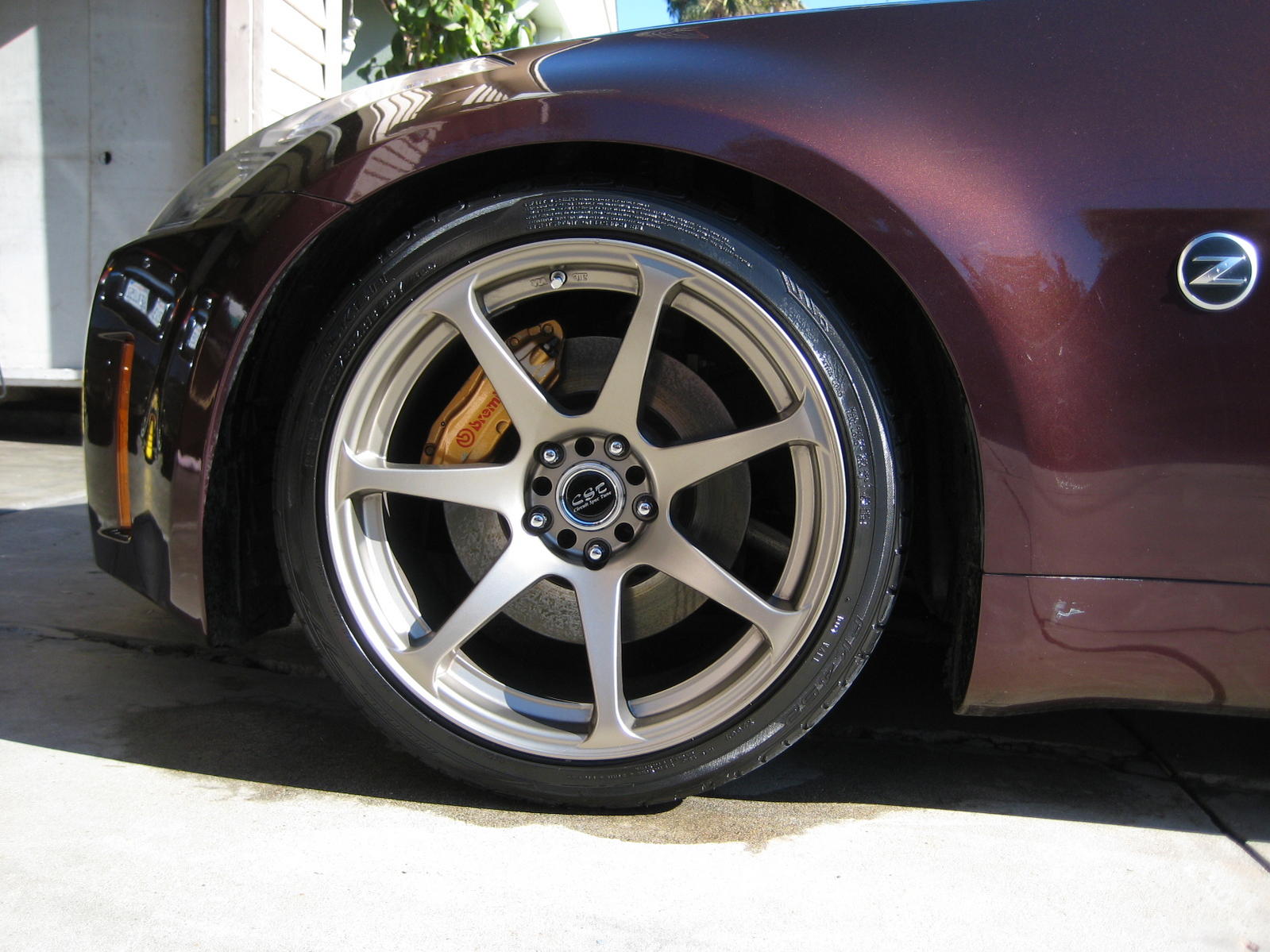

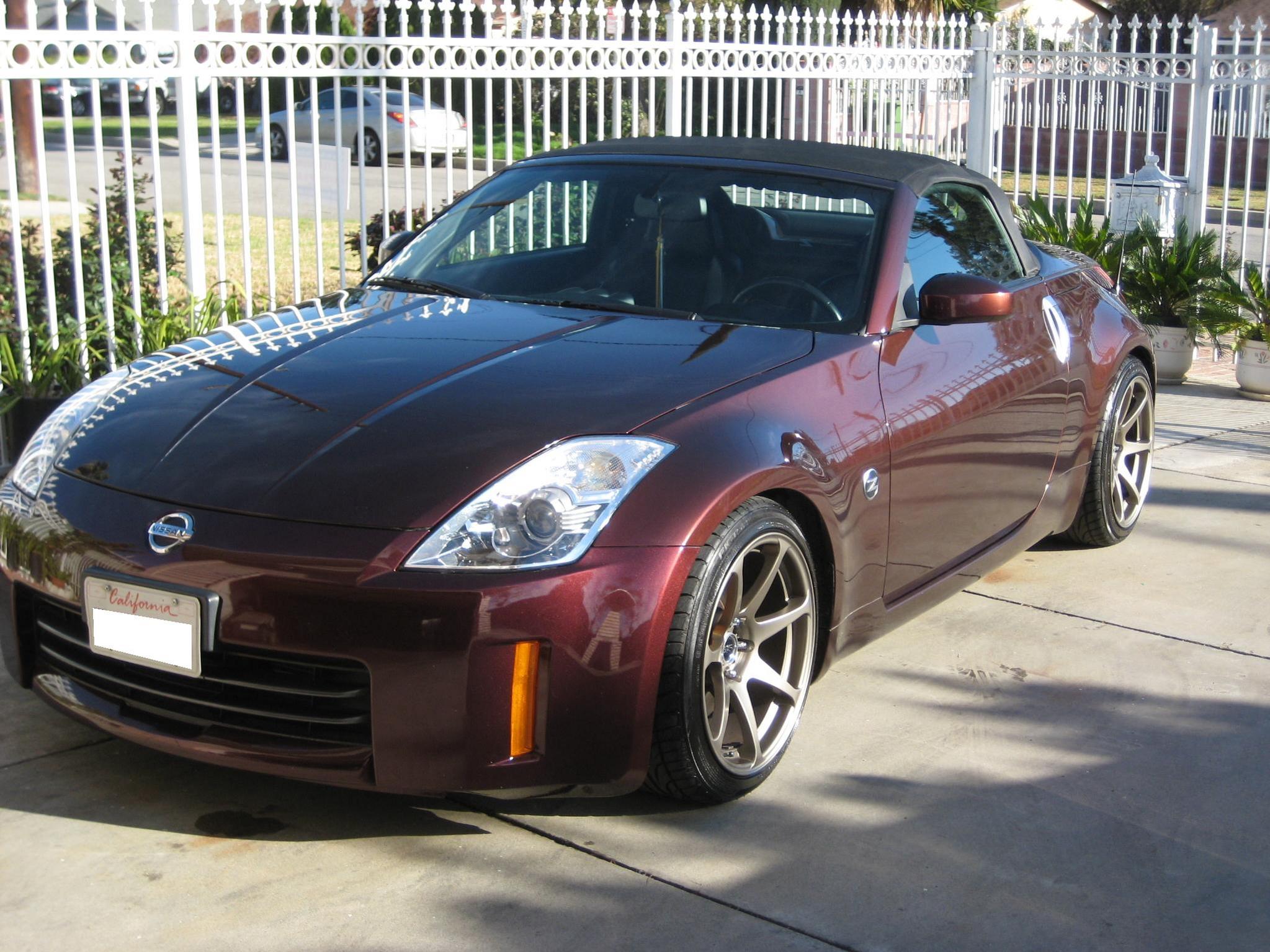

Default Circuit Sport Tune Wheels
18" 9.5in +23 offset all around( -2 rear with 25mm spacer)
235/40/18 falken tires all around
dropped on Eibach Pro-Kit
Attached Thumbnails 18" Wheel & Tire Discussion Thread-036.jpg   18" Wheel & Tire Discussion Thread-224.jpg   18" Wheel & Tire Discussion Thread-spacer-001.jpg

Why such skinny tires? Are you one of those hi-milers?
Originally Posted by AdvanZ33
I just ordered these 18x8.5 +32 and 18x9.5 +42 Super Advan SA3s and TireRack recommends 225/45-18 (f) and 265/40-18 (r). I also have Track Brembos installed. Any objections to that? No suspension mods done yet but I was thinking of going with some Tanabe NF210 springs for a subtle 1.2 inch drop because it's a daily driver and I live with speed bumps daily. Any insight would be great!
I do not think you will like those offsets with that aggressive of a drop. Look at the picture above of the 18x9.5+17 and imagine your wheel sunken into the wheel well an inch more than that. Probably more-so with the camber from a 1.2" drop. That drop is not mild IMO. I scrape speed bumps sometimes and I'm only lowered on Hotchkis. You will also have to have aftermarket camber arms and toe bolts installed if you are interested in getting your car aligned back to factory spec.
