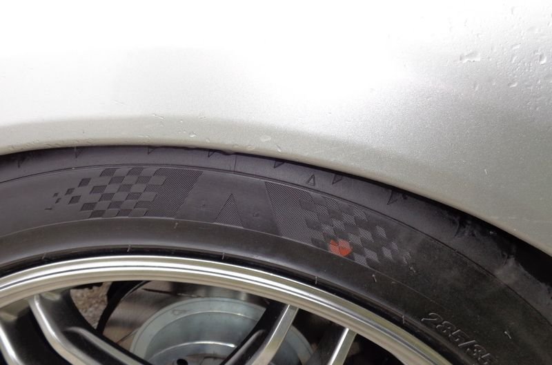

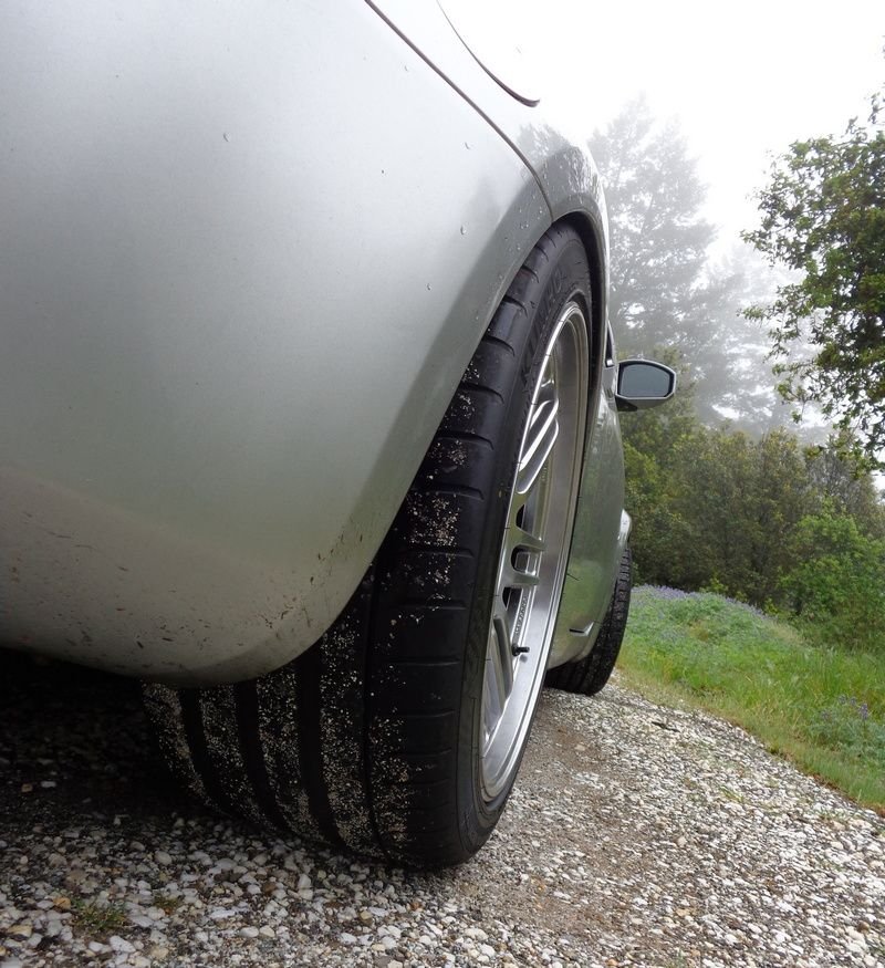

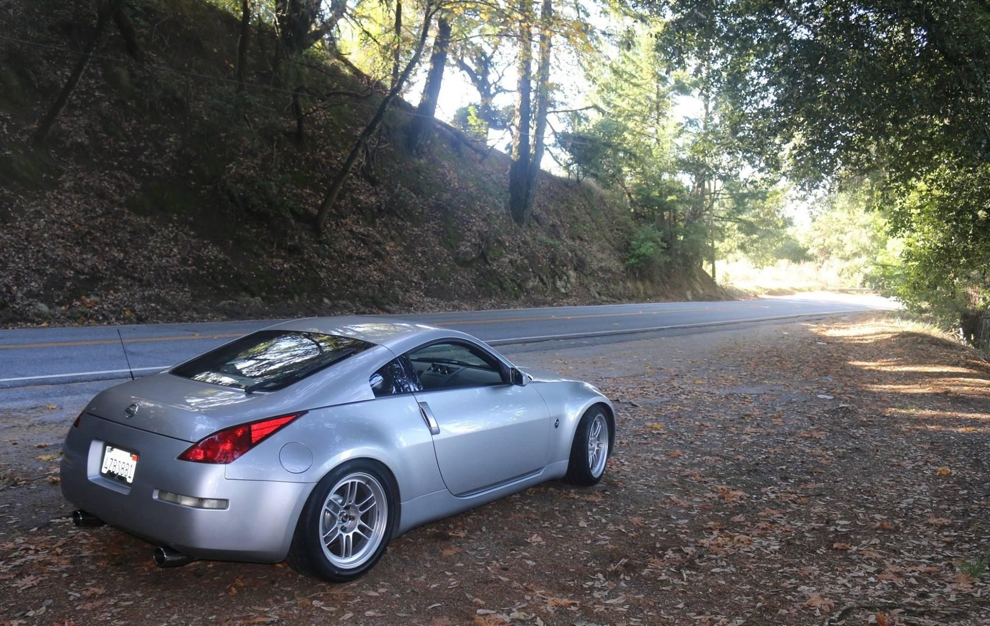

Unless you are deadset on RPF1s, there are other wheels available that use the same flow formed construction (comparably light and strong, moderately priced, like Enkei flow formed wheels). Matter of fact, the Enkei MAT process is a derivative of Konig flow formed wheel engineering - one of the pioneer wheel mfgrs to use the construction technique. Subsequently, Enkei, ahem, "borrowed" from Konig and re-marketed as "Enkei MAT" - Most Advanced Technology. Not sure if they licensed the technology or what but whatever they did, they ran with it very successfully.
Sidenote: Always like to show my favorite fitment (and post a pic because I kinda miss my Z cars. Laff...But just for comparison's sake.
Enkei/AME 19x10.5 +22 natural fit (no spacers) 285/35-19 Kumho PS91 (great alternative tire to Michelin PSS surprisingly and at lots less $$) I think this was before I rolled/sealed fenders as I ran the RPF1s the same year; so not sure. (Memory isn't what it used to be, haha.)
