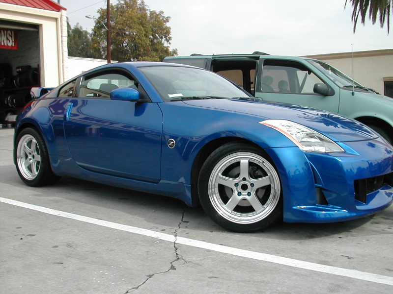

Here is a picture of my old setup with 275/40/18 in the rear. Swappd it out for 275/35/18 now. Because the 40 series tires were rubbing in the rear due to my 1.2 inch drop.

thank you man, are those pics with a drop.

What's the offset and width of your wheels. I plan to lower on Nismos so need to know if I am gonna rub.

The specs are 18x9+20 Fronts & 18x10+18 Rears.
