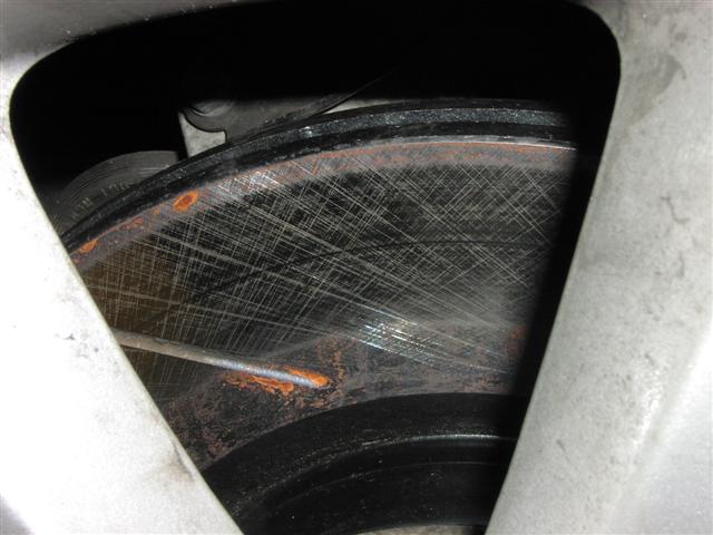

Default Trying to post pics..
I attached a pic of my rotor after bedding... if it works that is..
