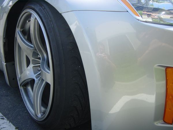

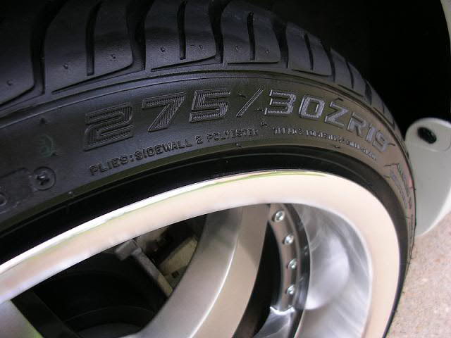

BTW, can anyone explain exactly what tire "stretch" looks like? I know a lot of people mention it, and it is considered a bad thing, however, I was never quite clear on this concept. Can somebody elaborate? Possibly post pix of stretched vs. non-stretched tires? My understanding is basically that a stretched tire barely covers the wheel width, whereas a non-stretched tire may be as wide as or wider than the wheel. Or maybe I'm completely wrong
Easy, tire stretch pictures are below.
Remember how tire sizes are, example:
275/35/19
275 - represents the width of the tire in mm's.
35 - represents the height of the sidewall, or the Aspect Ratio. It is a percentage of the tire width. In this example, you would take 35 percent of 275 millimeters and this would give you the sidewall height.
19-And of course this represents the diameter of the center of the tire in inches.
So if the width of the wheel is too wide for the tire width the side wall will stretch. Now Im not sure how to scientifically say it and there are others here that can explain it alot better than myself but the pictures will explain it. I think there is some formula but honestly im not sure.
The pictures im putting, God i hope they dont get mad at me putting them up, are examples of some tire stretching as I see it.Beautiful cars and beautiful wheels, but the tire just looks "stretched". there is no protection of your wheel on the side wall, ie from curbing, maybe hitting a pothole etc.. but im fairly new at this. Im sure there are other reasons.

the pics in the 4th post are of a 30 series tire. a 275/35 will look a little different (better). a 275/35 doesn't look bad at all, imo, on a 10.5" wide rim. only thing that bothers me is protection from curbs, but drive careful and you shouldn't have to worry about that
