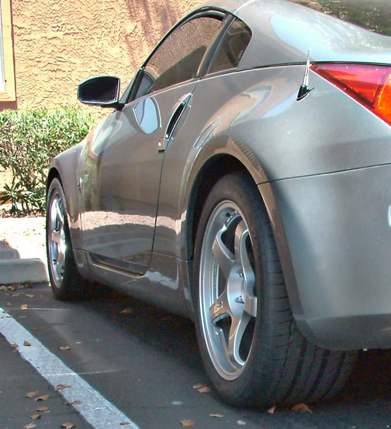

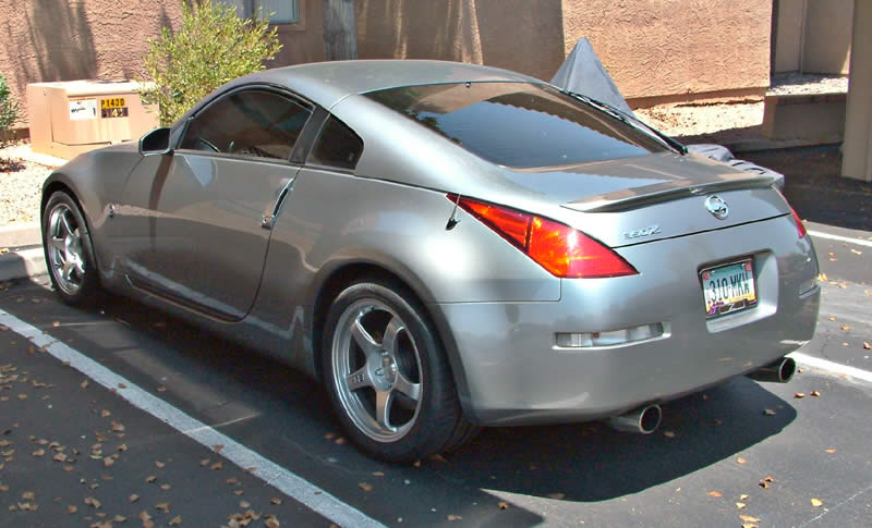

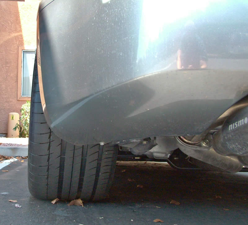

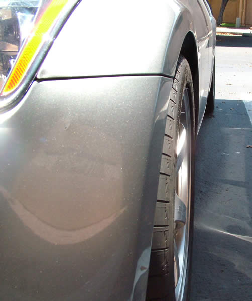

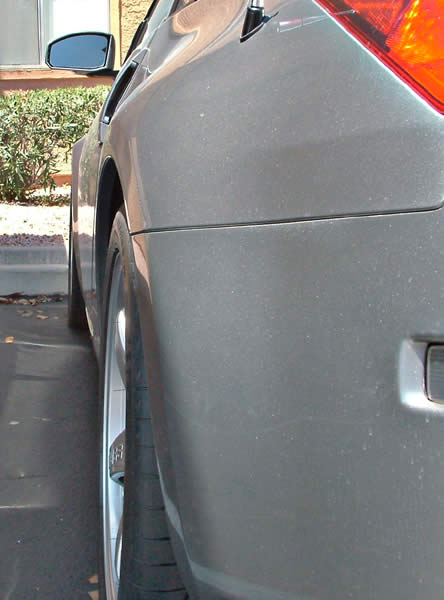

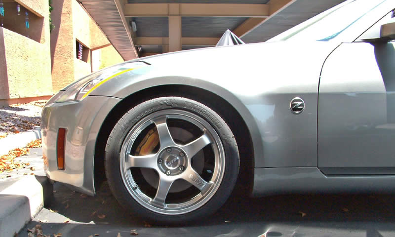

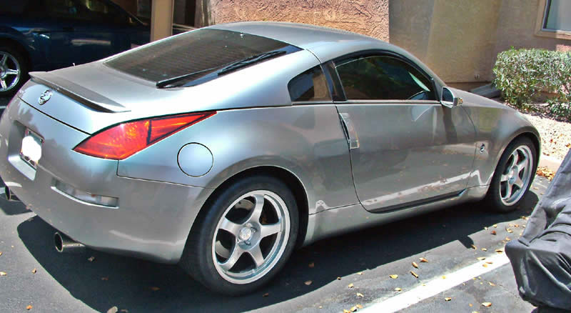

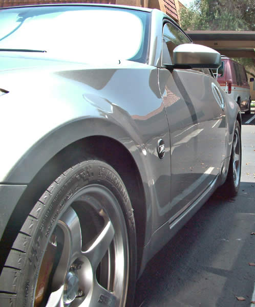

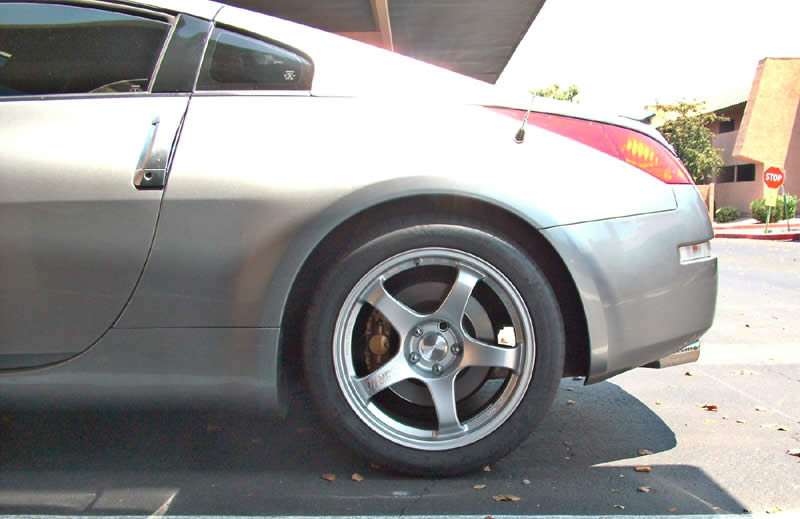

My tire sizes are 265/35/18 and 295/35/18 michelin PS2
wheels are SSR GT2's with 9 inch, 31mm offset front and 10.5 inch 42 mm offset rear. Both front and rears were brought out about a half inch outward from where the stock tires/wheels came out.
Aside from the SSR Comp H wheels, these are the only single piece forged wheels I could find that would hold the tires sizes I wanted and still be really lightweight. I think the fronts were around 18 lbs and rears were around 19 lbs. They also clear my brembo brakes.
the rears are really close to rubbing the inner suspension shocks, but don't.
I'm still on the stock suspension. I know the camber is a little off or more exagerated now. I'll get that fixed within a month hopefully with some 350EVO arms

Looks awesome bro. I really like the "no rear mud flap mod", I may have to do this.
