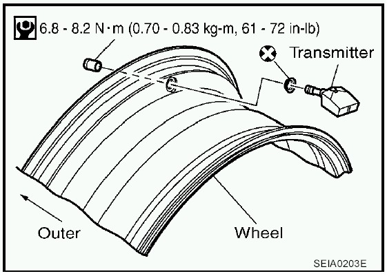

ya usually only works with1 piece. If its two or more u wont be able to because this is how it attatches to 1 piece wheels like our stock wheels:
https://my350z.com/forum/attachment....chmentid=11087
The tps litterally becomes the valve stem aswell. With multipiece wheels there is usually a 90 degree bend which the tps can not do because its completely straight.
