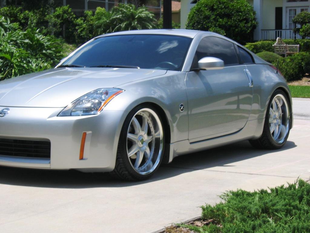

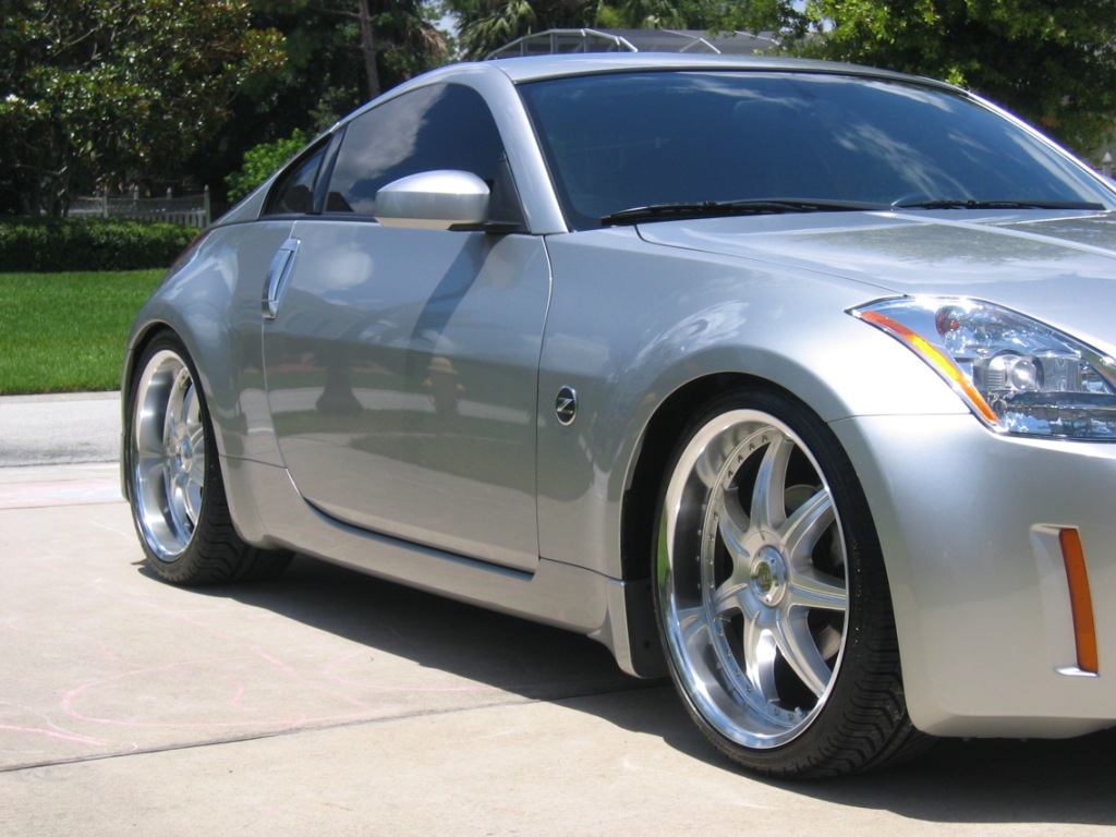

I agree with Mike and davidv.....do your homework. I had those offsets and it did NOT look "tucked in." Check it out. Tire size can make a diff.
Attached Thumbnails Is this offset ok?-img_0736.jpg   Is this offset ok?-img_0734.jpg
