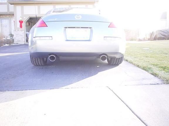

after searching the web for 2 weeks looking for a decent set of 18's that would fit my needs, i finally just bought a set of all-seasons for the stock 17's. i am was not about to be caught in another snow storm with the summer tires.
after much research and calculation (www.c5-corvette.com/tirecalc.htm) i went with pistolpete's setup with 245/45 up front and 255/45 out back. these are the largest tire sizes recommend for the stock wheel widths. the tires are sumitomo htr+. they are rated nearly as high as the michelin pilot sport A/S and cost half as much.
as you can see in the photos, there is minimal, if any buldge.
as many of you know, finding a shop to mount the tires is a pain in the ***. most nissan dealers, as mentioned, do not have the proper equipment with plastic retainers to hold the rims in place without scratching them. Discount Tire Co. does, but wanted $200 to mount and balance.
i found a shop in chicago (www.suburbantire.com; glendale hts store) to changeover and balance for $60 for all four. they are by far, the most professional tire shop i've ever seen. they inspected all wheels before and after for scratches, cleaned the rims, dressed the tires, and used chrome stems and caps.

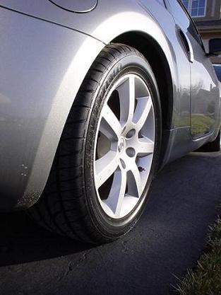

front

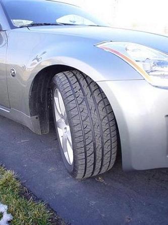

Default rear 3/4 view
255 on rear

I was really interested in the Sumitomos in your size. How does the turnin feel in comparison w/stock? Also, since the ires are at the limit of fitting for the stock 17s, are you increasing the psi? If yes or no, why? What did your installation shop have to say about going to the larger tires?
I am asking these questions because I have gone to a larger tire in the past and had some problems w/fitting 205/5515s to 5.5" rims. They felt underinflated, so I bumped the psi up 2 psi as my normal limit. Do you detect any thing like I am referring to? Please pm me.
Boomer
